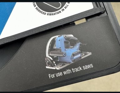

Hercules has a 158.75mm Track Saw Blade
If I’m not mistaken that’s a little larger than the blades for TS 55, but a little smaller than for TS 60.
Also, it’s 2.2mm kerf.

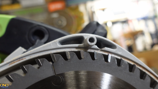

As pointed below, a blade that is 61/2" is .. more along 6.5" than 6.25" ... that is 165 mm and it DOES NOT fit inside the TS 55 series saws. If you try using it, it will seemingly fit .. and then proceed to "saw" off the metal piece holding the anti-split guard cover in place ..

Ooops, you are right. Turns out that the 6.5" is 165.1mm - and that is too large for the TS 55 EQ (and I'm presuming the REQ/FEQ, as well).
I was a bit curious and since $20 wasn't a crazy amount of money to give it a go, I did. The Hercules blade will seat in the EQ, however, when you pull the trigger you it hits and stops. The teeth look a bit proud of the upper housing and may have nicked a part of the outer shroud, but it definitely impacts with a part of the riving knife mechanism. I did not attempt operation further.
I suspect that the Hercules will fit in the TS60 since that blade is 168mm - though since I only have a 55, I am unable to test it out. On the 60, you'll lose a little cut depth but the Hercules might be a budget option - especially of Harbor Freight releases a wider range of blades when they release their own track saw (which is pictured on the packaging).
