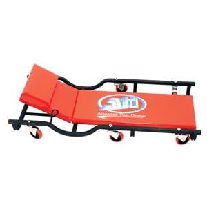

Mint idea Ill make sure all my decking is at least a foot from the ground so I can crawl underneath as I think bending down and twisting round to look up to screw is very uncomfortable.Ummmm but crawling under the decking doesn't sound very comfortable   umm maybe screwing from the bottom aint a mint idea [tongue]

Where does the tele mount?

I like it I would prefer it in Green and have a gear drive on it do I can stick my T15 on it and it pulls me along saves me using my legs in really tight spaces.
