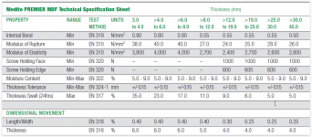

MDF isn't measured according to its "flatness" as far as I know so I doubt you'll get an answer there. Anecdotally though, relative flatness depends very much on how it is stored and the humidity conditions. You mentioned a variance of +0.4mm in an earlier post - that's most likely relative to a standard. For example, I've attached the technical specifications for Medite Premier MDF along with the standard details associated with measuring thickness.

Dave Lame said:
Sure would appreciate any numerical responses to the original question.
Here's an excerpt from a specification paper on MDF that I tried to attach but couldn't. While it's not a flatness spec, it does address
the thickness tolerance which can give you a rough idea of what you're up against.
Thickness tolerance (EN324-1)
Whilst board manufacturers have complete control of thickness calibration at the mill and can easily achieve close tolerances, any significant changes in moisture content during transportation or storage can adversely affect the thickness tolerance of boards reaching the user. Consequently attention to correct storage conditions at all stages of the supply chain is recommended. A close thickness tolerance is required for MDF used for wood veneering and foil laminating, finishing through roller coaters and membrane pressing.
The European Standard EN 622-1 specifies a thickness tolerance of ±0.2mm for boards up to 19mm thickness and ±0.3mm for thicker boards.
