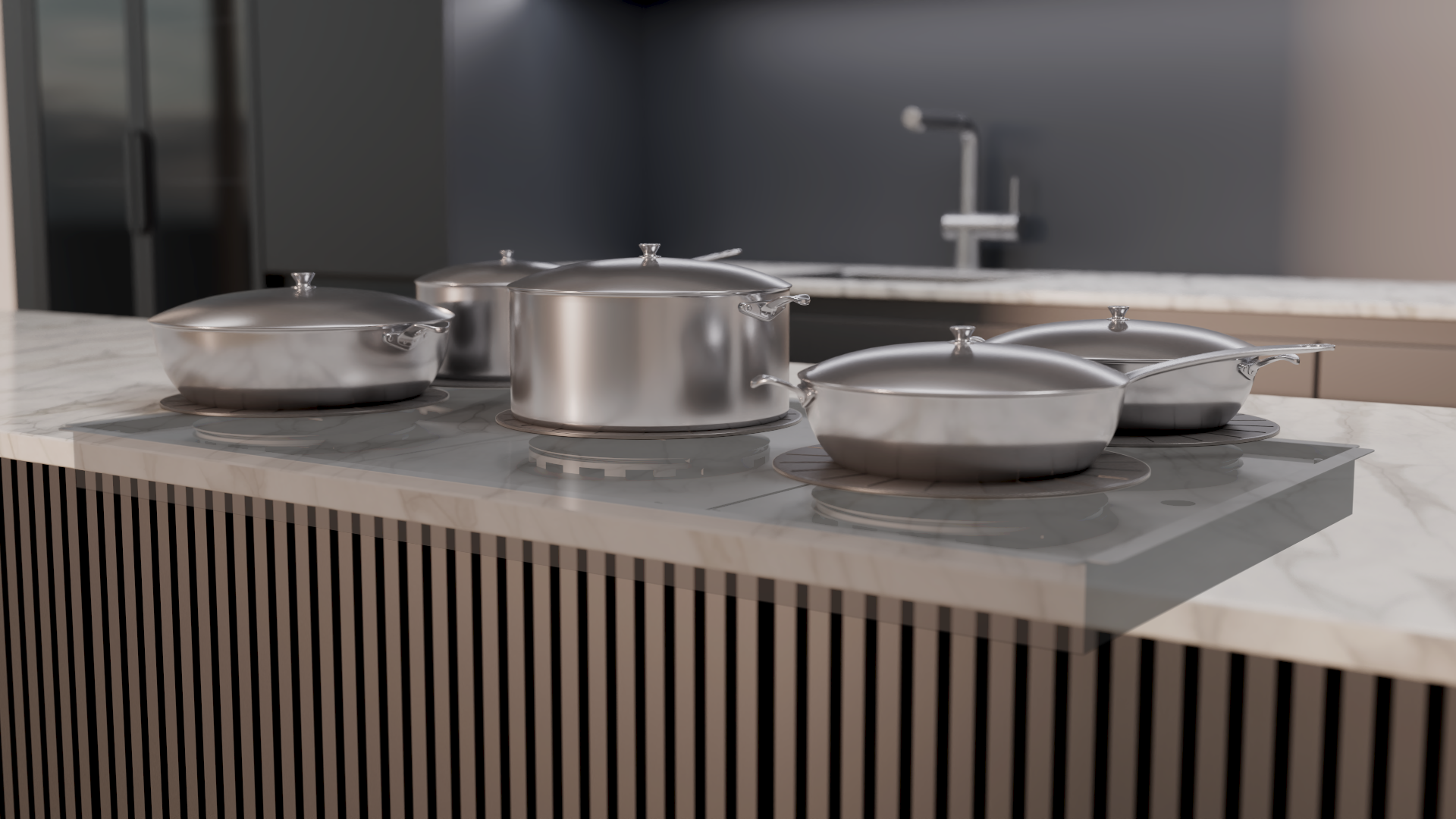

There is now available “invisible” induction burners. They place the induction generator under your stone countertop. I think I would like an etched diagram on the stone to indicate the burner location.
The under top units are not there yet. They kinda work but do not work well. Part of the issue is getting the pot located exactly where it needs to be.
That’s why they should include a suitable frisket film die cut to the right dimensions to allow a light etch on the surface. The etching process is simple and not particularly risky.
Once the frisket film is attached in the right location, it is simply painting the etching acid over the design. It would be a very shallow etching, so a fairly weak acid and a short exposure time.

The induction units can be placed anywhere there is room. Getting the film exactly where you need it would not be an be an easy task.
In most cases, getting this right would involve 3 different tradesmen/contractors.
The primary supplier of the appliances that go into our kitchens said the under counter induction units have a hard time getting the magnetism through 3cm tops.
AFAIK there is supposed to be at most 5 or 6 mm of stone or composite over the 'buried' units.

[…]The induction units can be placed anywhere there is room. Getting the film exactly where you need it would not be an be an easy task. […]
Not as difficult as it might first seem. I could cobble together a specialized “T-square”. The T-square would have one side the exact thickness of the countertop, and would have two precisely set “arms”. One mounted on the top side of the matching thickness material, and the second at the bottom side.
With that, you can easily align the underneath induction generator with the pattern to be etched.
I made one of these double arm T-squares to accurately cut an opening in my countertop (butcher block). Instead of tedious measurements, simple alignment and indicator lines for the cut.
The T-square took about 20 minutes to make, but because I was worried about it getting out of alignment, I added glue. So it was ready to use the next day.
