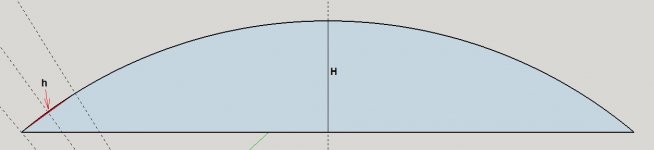

Cheese said:
If your 10' long rail only deviates by .010" or less, then you're straightness is .001" per foot.
It is actually 0.00016" per foot. This is arc (circular) where height to length relationship is non linear.
First, did you mean 0.0016?
Second, I don't agree that it's not linear, at least as far as how Cheese phrased it.  If you are out exactly 0.001 per foot, you would be out exactly 0.010 over 10 feet.  There was no mention of an angle.
No, I meant 0.0001".
I mentioned that I assume circular arc (which is a fair assumption, also see OP).
The height of the segment is h=R(1-cos(alpha/2)). Non linear.
Look at the difference in segment height H and h in this greatly exaggerated picture. In shallow arc the difference is even more pronounced.
If the shape of the curve is unknown, than we can not downscale deviation from 10' to 1' and there is nothing to talk about (as in Cheese's comment).
Forgive my monologue, I'm obsessive-compulsive, which is what we have in common with the original poster.  [big grin]
