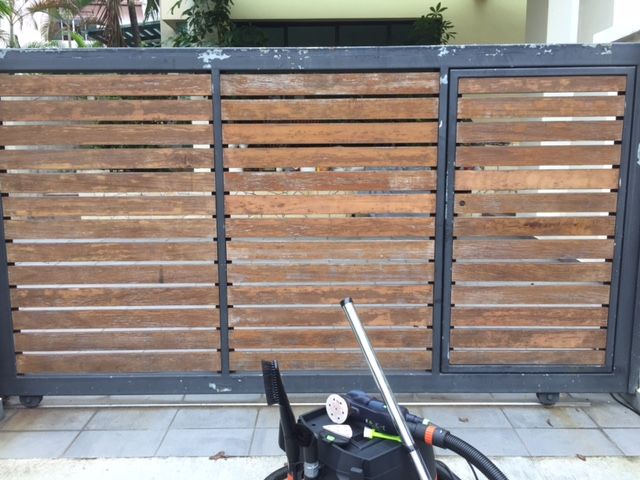

Hi folks,
I've managed to strip off the paint off my gate using the RO90.

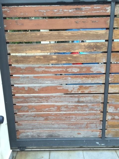

However, as you can see in the second picture, it is very blotchy.
I couldn't get the wood to have a consistent tone.
Having taken a very long time to strip the paint, I no longer want to paint nor varnish.
Will staining the wood make the tone consistent?
The wood species is 'chengal' http://en.wikipedia.org/wiki/Neobalanocarpus
Thanks for your help.
Before
(The 3rd, 4th and 5th have been sanded but still appear blotchy)
After
(All the wood have been sanded)
The colour difference is wood colouration due to weathering. If you want to get a more even colour you'll have to sand more, until the discoloured layer is completely gone. Rubin 2 would be my prefered choice of sandpaper for this.
When you stain it the colour difference will become less but will still be visible.
Thanks Alex,
Yes I thought sanding deeper would solve the problem so I used granat 40. The outcome is strange as each piece or the piece itself produces different tones. Sometimes raw fibres are exposed, sometimes it just turns dark. Also, I could hardly remove material even though I use granat 40 and in rotex mode. Do you think letting it sit in the sun for 6 months or more would even things out and make it look natural?
