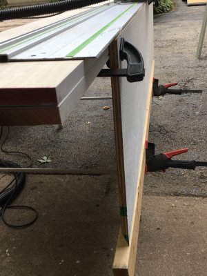

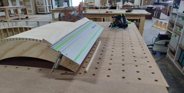

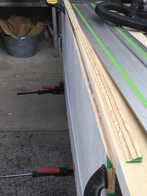

How To Make Triangular Length of Wood?
How about the style that Wes shows?
That is the work around, since it's a lot harder to cut bevels over 45 degrees.
It's far less susceptible to damage, on the corners, but the look is not the same.
