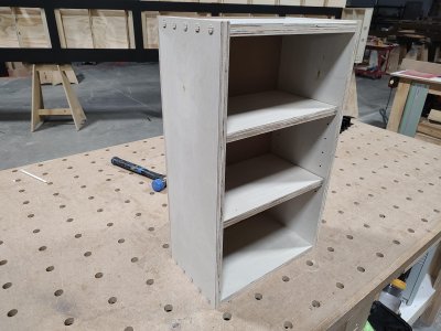

I usually go to my workplace on Saturdays, not on the clock. This is the time where I work in personal projects, either my own or for someone else. Sometimes it's only a couple of hours, before my lunch meeting. The time I show up just depends on the size of the project or how motivated I am to do it. Today the meeting was cancelled, so I had a few hours to get something done, uninterrupted.

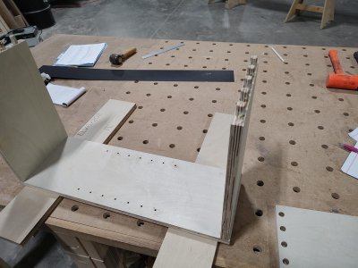

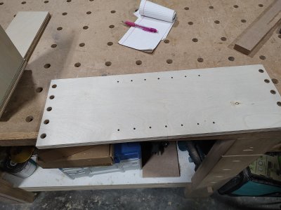

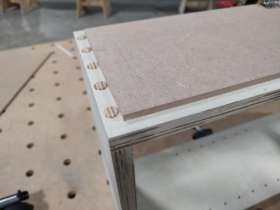

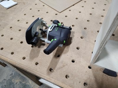

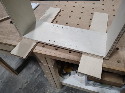

I decided to make a little cabinet/shelving unit, out of some scrap Asian Birch ply. It is a Shaper Origin project, featuring integral "dowels"/tenons in the top/bottom. The "dowels" are relatively large, 1/2" diameter in 18mm thick ply. This would make it very thin/fragile around the holes, in the sides. To counter that, I made the sides slightly longer, moving the mortices in 1/4" from the ends. My plan was to cut the excess off, after the glue was dry. That all sounds fine, until you realize that I left the tenons proud of the surface about 1mm. A spacer, of some sort, is required to get around them. It could be done with a router table, but you would have to secure the spacer in some way. It could be done with an L fence, on a table saw, but you have to take steps to eliminate tear-out. I decided to do it upright, with a spacer, clamped in place. This is a perfect use-case for the extended base for an OF1010 (or OF1400). It provides a lot of stability, when hanging out that far. I used the Shaper for the shelf pin holes too.
Thanks. For now, it's in my kitchen, housing my waxes/oils and mixing unit. Eventually to hang on a cleat wall in my home shop.
It takes quite a bit of time to cut the pins, but only a few seconds for the holes. As Russ from Shaper says, Origin is the world's most expensive drill press.
Nice...curious how proud you left the "dowels"?
Maybe around .002"-.003"?
I also picked up the plastic extended base for my 1010. I really wanted the original phenolic version 493139, but that's long gone. :)

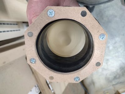

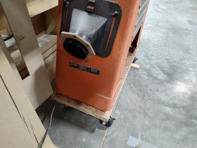

@luvmytoolz It certainly is. Clean, smooth, exactly placed, etc. You can even do fun stuff, like running a tapered bit around the inside and get a conical hole. I have a 4 degree bit, but there are several others 6, 8, 10 for sure. I used it for the inside of the holes on the magnetic flanges that I made for quick change dust collector flanges. It makes much better contact with the tapered tube fitting, not glued, just friction fit. Now I swap between the miter saw and jointer almost instantly. That's something else I did on a Saturday morning, except it was about a year ago.

@Cheese No, actually they stick out about 1mm. I cut the pins to a depth of .760 and the ply itself is 18mm, which measures .720ish. I knew they were going to be proud enough to "matter", so I ran a bevel bit around the ends, hoping it would not only make assembly easier, but not leaving a square edge. I did the same around the inside of the holes, to also give any extra glue somewhere to go.
