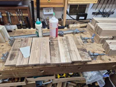

But what I really want is one that gets the amount right without a ton of squeeze out or causing hydraulic resistance so you have to beat the crap out of it with a mallet to get the joint to close. Don't ask why I worry about this.
What I REALLY need is a METERED Domino glue applicator.....anyone got a best practice?
I have seen some furniture makers apply glue to only the mortises (as well as the joints) but none on the dominoes. For panel joints, some even use dominies for alignment purposes only and don't put any glue in the mortises and dominoes. I think those are user preferences rather than best practices.
For all my domino as well as non-domino projects, I put glue to everything, aiming to see a tiny bead of glue squeeze-out in the joints. I use a mallet to seat the dominoes but clamps to close the joints.
Drilling a small hole through the Domino to let excess glue escape if you get hydraulic lock. Not using glue fixes the problem altogether.
When I glue the Domino in (don’t always bother) I apply glue in the mortise with a bamboo skewer. The skewer only holds enough glue to lightly coat the walls of the mortise. At this point I’m wearing nitrile gloves and I put a drop of glue on my finger and wipe it around one end of the Domino and insert. Little to no external glue to wipe off.
I dip the domino. You soon get a feel for how deep into the glue is far enough for no or minimal squeeze out. (There are a few factors to consider that complicate using an exact measure, eg constituency of the glue, environment, type of wood, type of glue, etc. — So doing it by feel works better IMO.)
I just use a GluBot. After a while, you get used to how much comes out, with a practiced squeeze. It really doesn't take much, just enough to hit the bottom and be forced back up part way. It doesn't need to squeeze out, it better if it doesn't. On big glue-ups, I let them dry, to have fewer to insert on final assembly.
