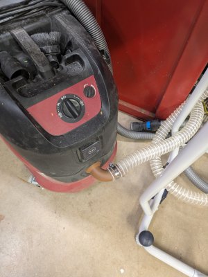

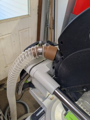

This is what I came up with. I've got it on my FLEX dust extractor. I also have a MIDI and will try it on there to be sure. If everything checks out I'll post it on Printables, but won't have time until tomorrow night.
Yes, that hose you linked would work fine.

Thanks all for your replies.I have found some 38mm hose from Charnwood and I think that will work well if I can get adapters for both ends. @M&Swoodshop it would be great if you are able to share the Kapex end fitting which is the one which I am unsure about - it has what looks like a male bayonet fitting which I assume you have designed your connector around
Thankyou very much for this.
I will definitely use the bayonet Festool end, will get some 38mm hose to use it with. I see that limiting the hose length to <2m is important.
Separately, did the vac end fit your Festool extractor?
