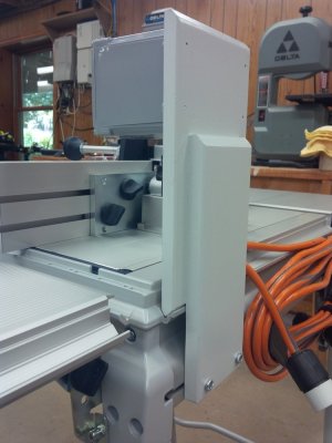

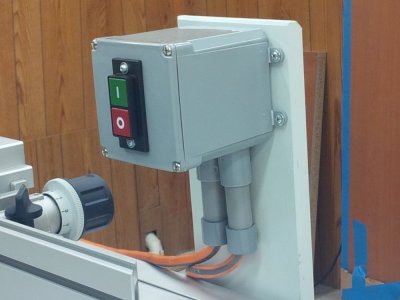

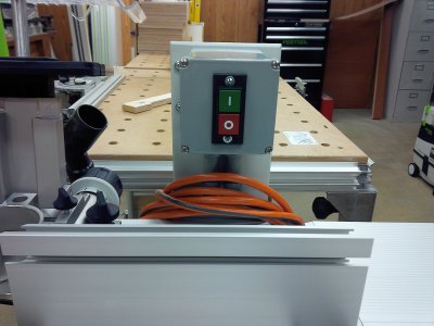

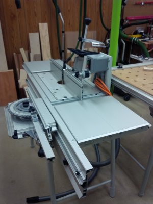

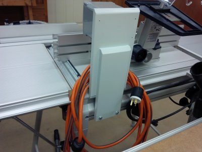

With all respect, the OF 2200 CAN be controlled from an external switch above the router table. I did it with my CMS to resolve the issue that Peter mentioned. That issue is exacerbated by the use of an infeed table extension, making the use of an under-CMS switch even more problematic. I built my own solution using a 20-amp switch in a box attached to the rear extrusion of the CMS frame, and it works superbly.
Your 2200 is prior to 2020 isn't it? The newer ones are designed so that if it is locked on and there is a current interruption it will not turn on until the locked trigger on the router is released and then depressed again.
You did your mod to get past the amp limit of the factory supplied CMY switch, correct?

Yes, and yes. There were two main reasons; getting my ugly face well away from the spinning bit should things ever go to worms and I needed to shut it down right now, and bypassing the 15 amp limit imposed by the stock CMS switch. I also use both infeed and outfeed table extensions, and the infeed table obstructs access to the stock power switch.
