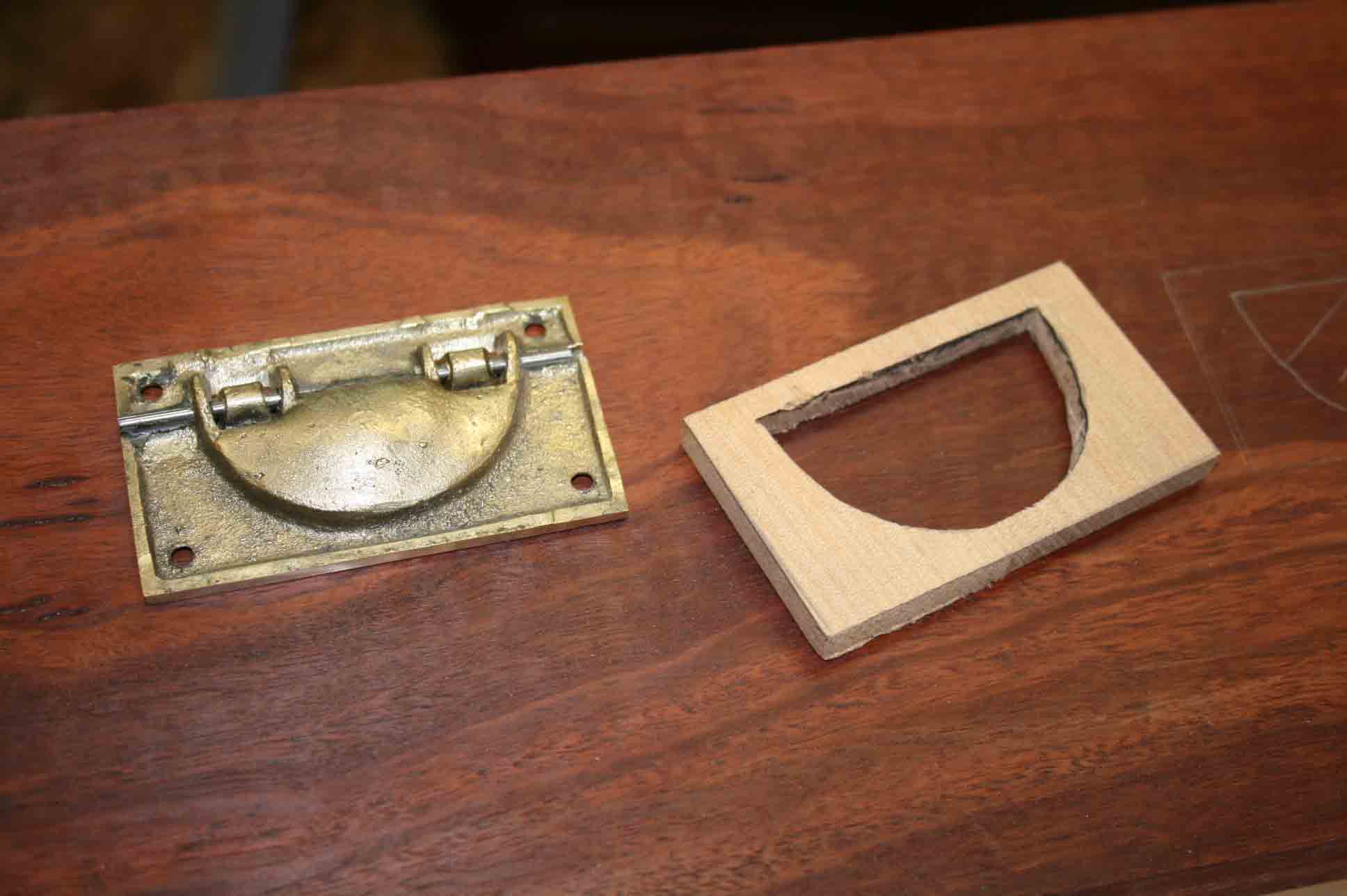

Templates
A template is needed to position the handles on the drawer fronts, and another is needed to outline the recess for each handle.

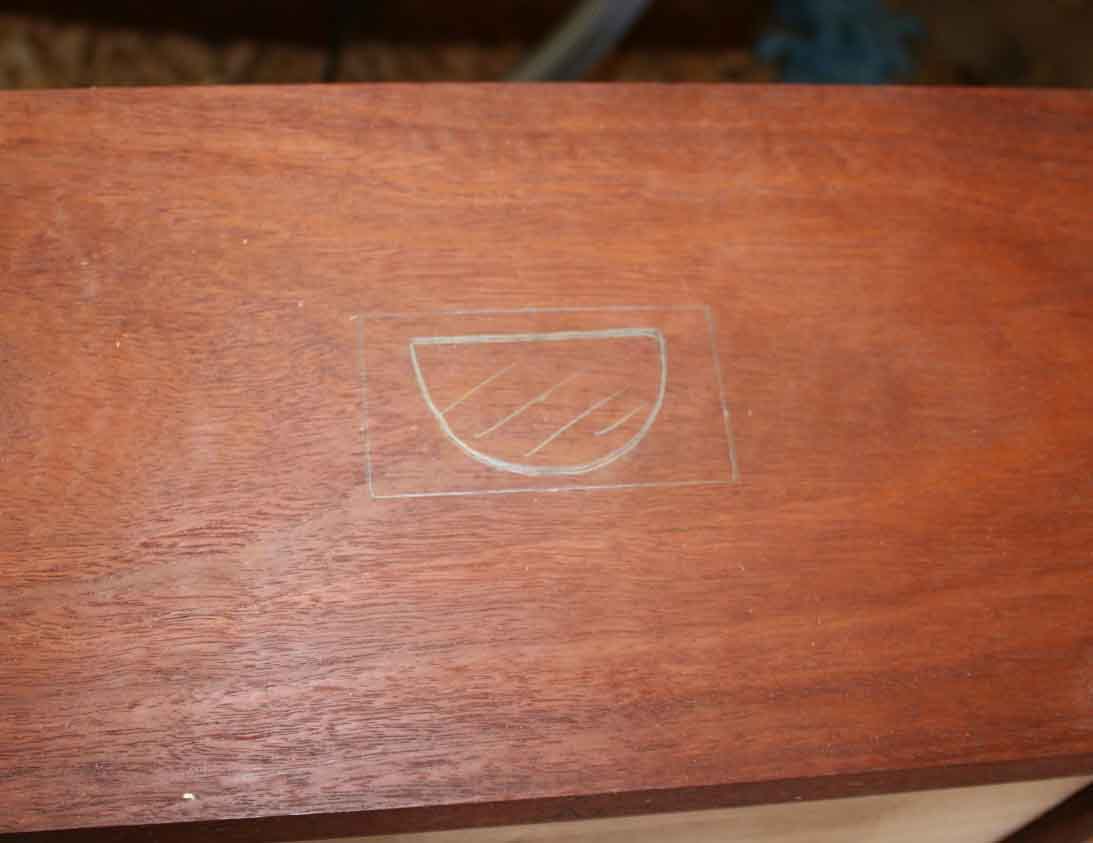

The template for positioning was made with a sheet of copy paper …
The position was traced in with a pencil.
… while a template for the recess was shaped in MDF to reflect the shape at the rear of the handle …
The combination of the two above produced this …

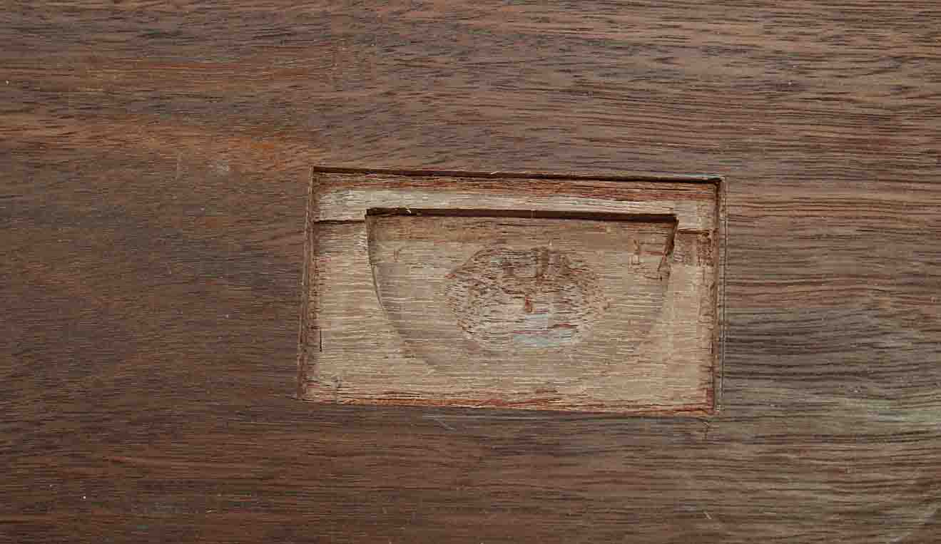

The waste is removed with a router, again freehand, and as close to the lines as I dare go.
The remaining waste is removed with a wide chisel.
Once this is done, recesses are required for the hinge bar on each side, and a little extra depth was created with a gouge for the domed rear …
The result …
