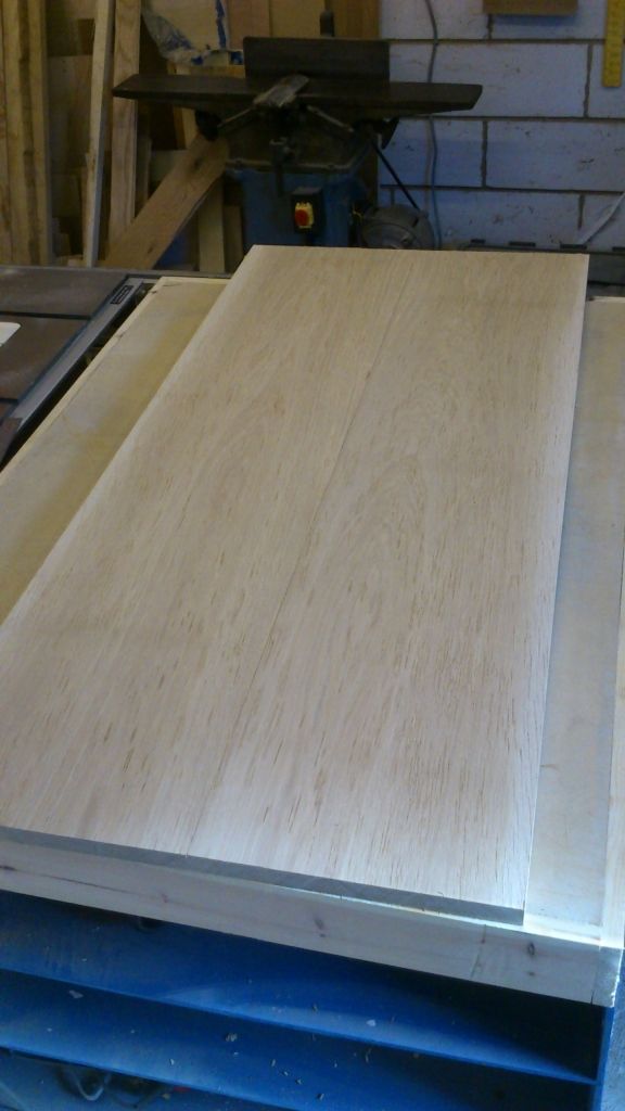

Now laying up to get the final size of the main panel, no mistakes allowed here:
And once I'd got the panel to the right size I put it through the saw. This was super dust as its a 60mm deep angled cut. Full respirator required! I tried the Chatinger method out on this one. It didn't really help as it made the panel heavy and more cumbersome. But for a smaller panel it would defo be good. Plenty of burn and stuff here:
But nothing that won't plane and scrape out, the £11 I spent on my Lie Nielsen card scrapers was the best £11 I ever spent. Just the two closest sides cleaned up in this picture:

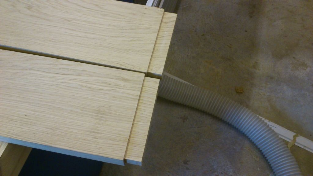

Finished off cleaning the main board and have a quick test fit once I'd grooved the rails and posts:
Then drill for the dowels before spending ages sanding and rounding over all the edges, just a few passed with a block plane and then some 180 grit has given them a nice feel.
