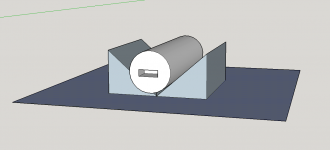

I hope this makes sense.
I'm trying to work out how to cut holes in short dowels (100mm long, 30mm in diameter) to insert dominos on each side. I've come up with an idea for a jig which would involve clamping the dowel between two sections  - see the picture - imagine the same size jig on top of the domino clamping it down with screws.
I would then place the domino on top of the jig set at the right height and cut the holes, flip it around and cut the other side.
Any suggestions on improving this idea? Anyone tried it or something like it?

The Festool Domino Round Stop Attachment is certainly based on this principle but I guess since the specs say the minimum diameter is 35mm I guess that's out of the question. Also I don't know if there is a safe minimum working length to the dowel for the official accessory. So it looks like you're sort of scaling it down a little.
I've looked at the Round Stop Attachment - the problem I run into is holding the dowels in place. It would be much easier if I could get some clamps on the back of it but they're to short to clamp and put the domino joiner on top.
I also figure it would hold it in place so I could get the same alignment on each side of the dowel.
  How about using a jig like you have shown with a top piece to clamp the dowel down. Set it up so that your domino will be centered by resting the bottom of the joiner on the flat surface in front of the dowel. In other words reference off the "table" surface with the fence in the vertical position  rather than using the fence in the horizontal position to reference off the dowel. The flat "table" surface could be and probably should be part of the jig.
    Also add a vertical backstop to the jig to push against. And put a mortise in the backstop that will align with the mortise in the dowel.
  Clamp the dowel into the jig, cut the first mortise, insert a domino, flip the dowel and push it into the backstop mortise, clamp down, cut second mortise.
    The backstop / domino / mortise will ensure that the mortises in the dowels are aligned in the same plane. Not twisted in relation to each other.
    The reference surface will also need side stops to keep the joiner in the right place.
Seth
I'd use the bottom of the Domino to index off of, we already know the center line of the bit is 10mm off of the bottom so you just need to add a 5mm pad to the jig to center the domino on the dowel and then you'd have enough space to clamp the dowels.
Yes, that certainly simplifies my suggestion.  [embarassed]
Although the set up with backstop mortise will ensure the alignment of the mortises in each end of the dowel, assuming that is important.
Seth
I agree with you Seth, a backstop is needed to ensure consistent alignment of the domino's along with 1 or 2 rails/pins on the raised 5mm pad to ensure finding/locating the center of the dowels easily.
Without consistent alignment of the domino's, machining the matching mortises in the "other" parts would be a nightmare. [eek]
How about a length of 8/4 stock with a hole in the center. [  o  ]. You may have to use an old fashion auger. That way the Domino would rest on the top of the 8/4 and you could center the mortise in the center of the dowel.  Just slide the dowel into the hole, hold it in place with a center marked on the top of the 8/4 stock.

That was going to be my suggestion as well Clark. Or to make it even simpler, have to parts of the stock on either side with the dowel pinned in between and set the fence stock accordingly.
If you need to have the dominos in both ends either parallel or perpendicular, you can put a domino in the back to have it line up properly when you mortise the other end of the dowel.
Cheers. Bryan.
