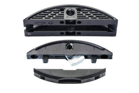

Looks like Lamello's released some more Zeta products, Lamello LC P-16 shells for lightweight panels, in 11mm, 17mm and 22mm thicknesses.
Designed for Clamex's but would work for Tenso's just as well.
Really interesting product:
