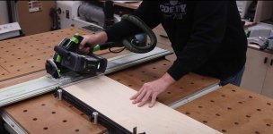

I've been on/off about finally getting a track saw. Watched a recent Sedge video and saw that he always rips with his left hand:
... so hard to know which handed-ness is best. For angled cross-cuts, I'd rather not reach across, but that looks OK.
Thoughts today?
Whatever hand you can comfortably have line of action forward without twist, tilt or any other misaligning thing.  You don't need to see the cut like you do with a CS.
Most of the time, this means rip left.  But I've been known to climb onto the plywood with the rail to my right.  Right hand dominance means I can use the left to lead and apply light pressure to the rail to keep it in position on tricky ply.
Other things like TSO parallel guides can sometimes make you choose saw left, just so you're not bumping into the parallels.

This is the Sedge video that made me think (and where my screen grabs came from):

I think we have to consider ripping separately from cross-cutting.
For ripping, I don't see an argument for the current setup being good for right handers. As the Sedge video shows, the track is on the good piece, which is typically wider than the off-cut, so you end up using the saw left-handed. For ripping.
For cross-cutting in the middle of a long board, it doesn't matter as you're reaching over in any case. If you don't clamp, there may be an advantage to the current setup in that you can hold the guide with your left as you reach over to run the saw with your right.
For cross-cut trimming, it's kind of like a mini-rip in that right handers would be reaching across while left-handers could just be on the smaller off-cut side (again, with guide clamped).
So, the only time the current setup is good for right handers is when the guide isn't clamped and you're using your left hand to hold the guide down or track square against the workpiece while your right runs the saw and you deal with leaning over the workpiece (and track square).

Here are some screen grabs from Jason Bent's "How YOU should be cutting plywood" (Funny, the "should" is the word to emphasize there, IMO):
For an initial rip to get a "clean" edge, he goes left-handed:
For a middle of the board rip, he switches to right hand, even tho it means swinging his body around his TSO guides:
[attachimg=2]
I found it interesting that he says he rips ⅛" wider than needed so he can clean up on his tablesaw.
For cross-cutting, he always chose right handed:
[attachimg=3]
That was a couple years ago. Since then he discovered the sliding tablesaw:
Of course, he's coming from a cabinet saw with the ungainly Incra aftermarket fence, so no wonder he was such a track saw guy previously.

He's not really deviating from what a lot of people are saying here.  Stay on the side closest and least awkward.  While I might contort a tad because of the TPGs, I also don't have the extra goof margin should I crotch-kick those parallels.  If I'm rough cutting like he is, I don't mind walking around the TPG30s like he is, but TPG50s are getting into International Limbo Championships territory.
Since you're on the fence on getting a TSxx, I'll point out that unclamped rails can shift depending on how dusty/bowed that plywood is.  For extremely long rips, I've had it slide a few mm's if I'm not careful.  To avoid it, you'd need to keep pressure on the rail forward of the saw (which is admittedly safer with the left hand, away from the blade), and watch those TPG stops like you would a table saw fence.  He's not watching that and is more preoccupied with the hose since he's giving himself 1/8" play space.
Or... you could get a STM1800 and clamp the rail to the plywood and avoid the shifting thing altogether.  It's the cutting on insulation foam that typically means we're at the mercy of unclamped rails.
Yeah, he mentions the advantages of the shorter TPGs in the video.
