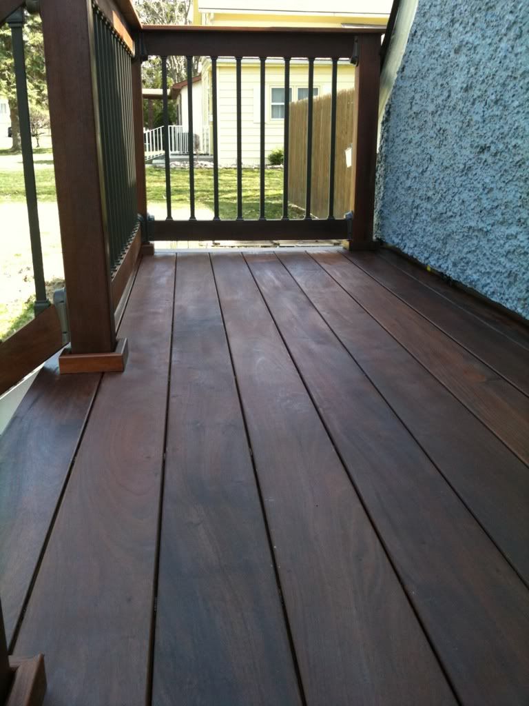

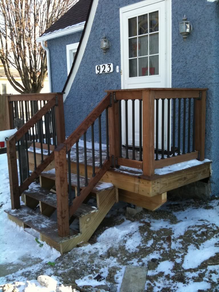

The customers had their basement waterproofed, lifetime warranty [unsure] and the old porch was in the way.
HO was smart enough to leave the front steps in place.

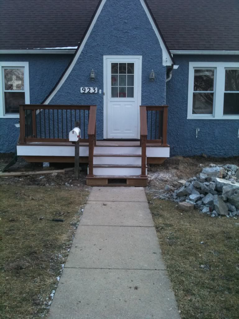

The set back from the middle of the street, is 1 foot inside the front door. [blink]

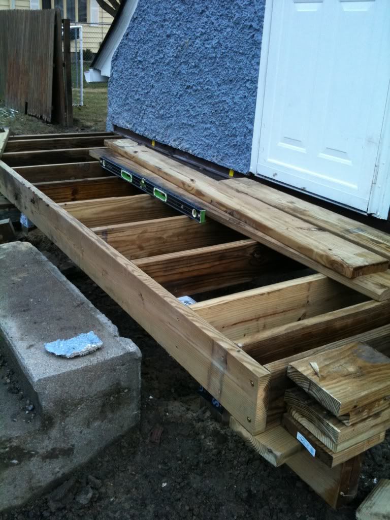

I was able to get a similar size porch approved (this one is wider).
The weather in NE Indiana has been ridiculous.  Warm and rain, then cold and snow, then warm and rain.  rinse, repeat.
I dug footings the day after christmas.

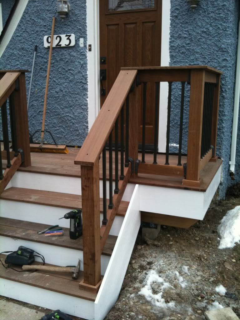

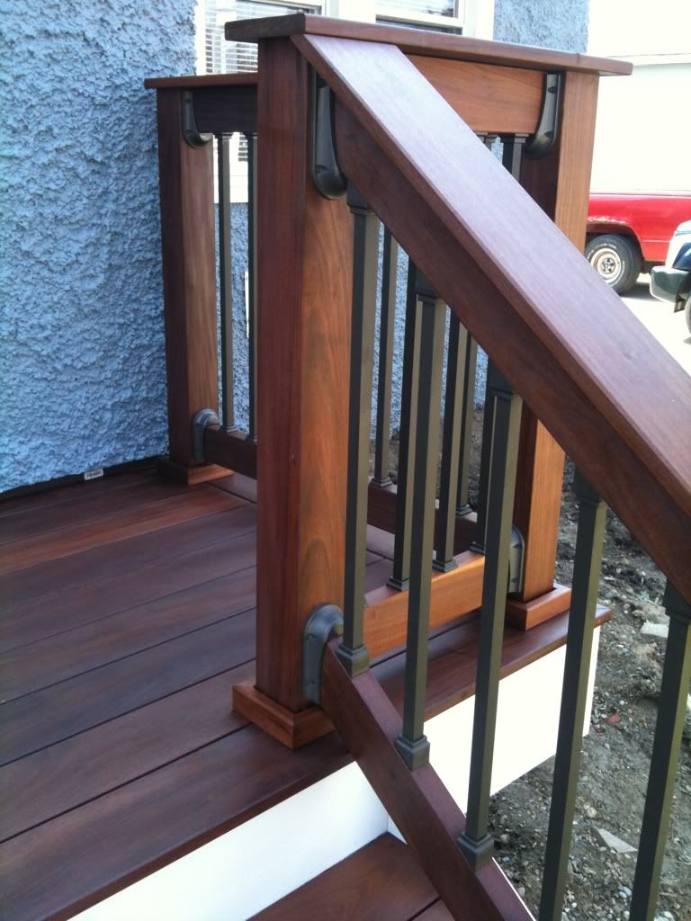

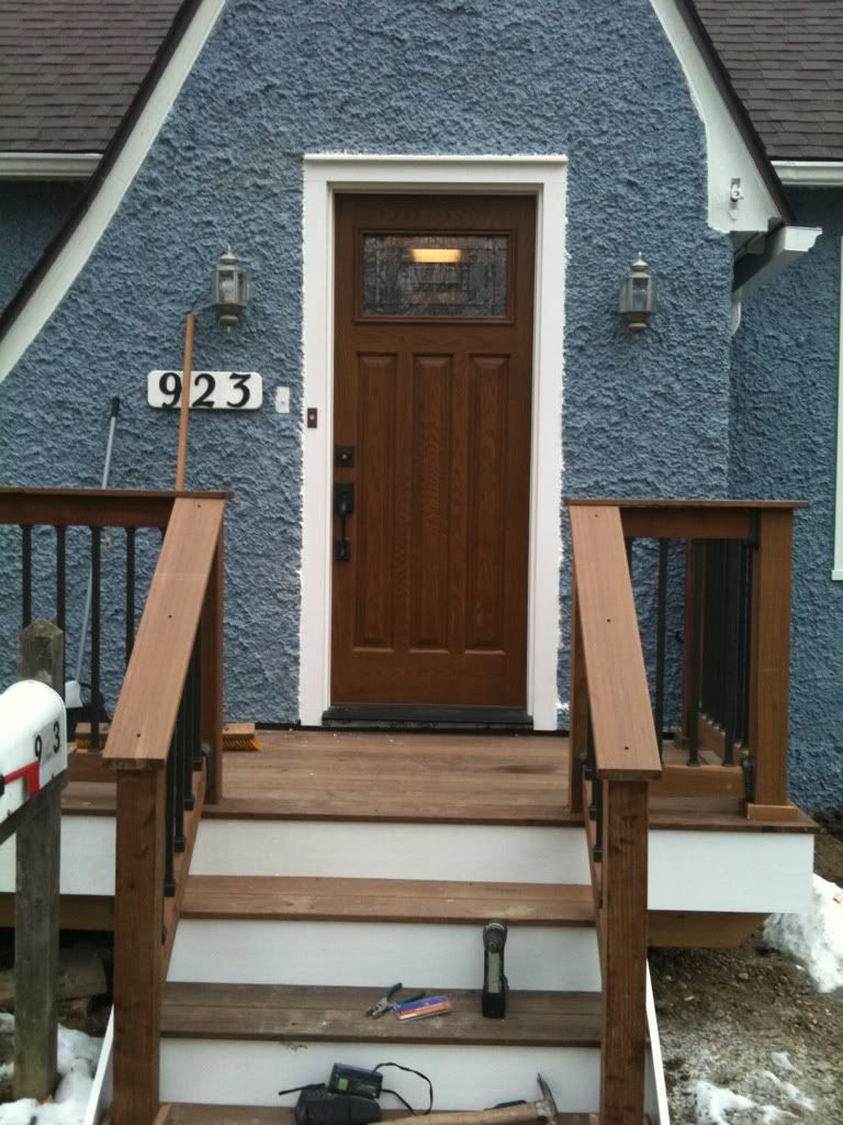

Ipe decking, crushed powder coated balusters, Excell (pvc) trim,  new door with pvc jamb and trim.
Just waiting on HO to pick out new lights, get new house numbers, and a mail box.
Will go back in spring and touch up paint, plug holes, light sand and oil.
Now they want a big one out back. [big grin]
All pictures are from my cell phone.

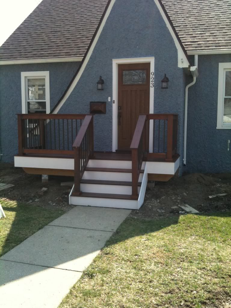

Very nice! Good choice of colors and contrasts. Interesting slope on that roof!
Nice work! The replacement of that front door really adds to the curb appeal of the home - and the deck is very nice too. I have admired your work both here and over on the CT forum.  Wish I had your skill set - If I did, I'd be doing construction full time rather than serving in my current capacity as a desk jockey.
Thanks guys.  The HO's did  a great job picking out what they wanted for a door and the porch.
It does not take much persuading or salesmanship to get a customer to choose a SA hardwood for an exterior project.
I am really happy with the transformation of the front of the house.

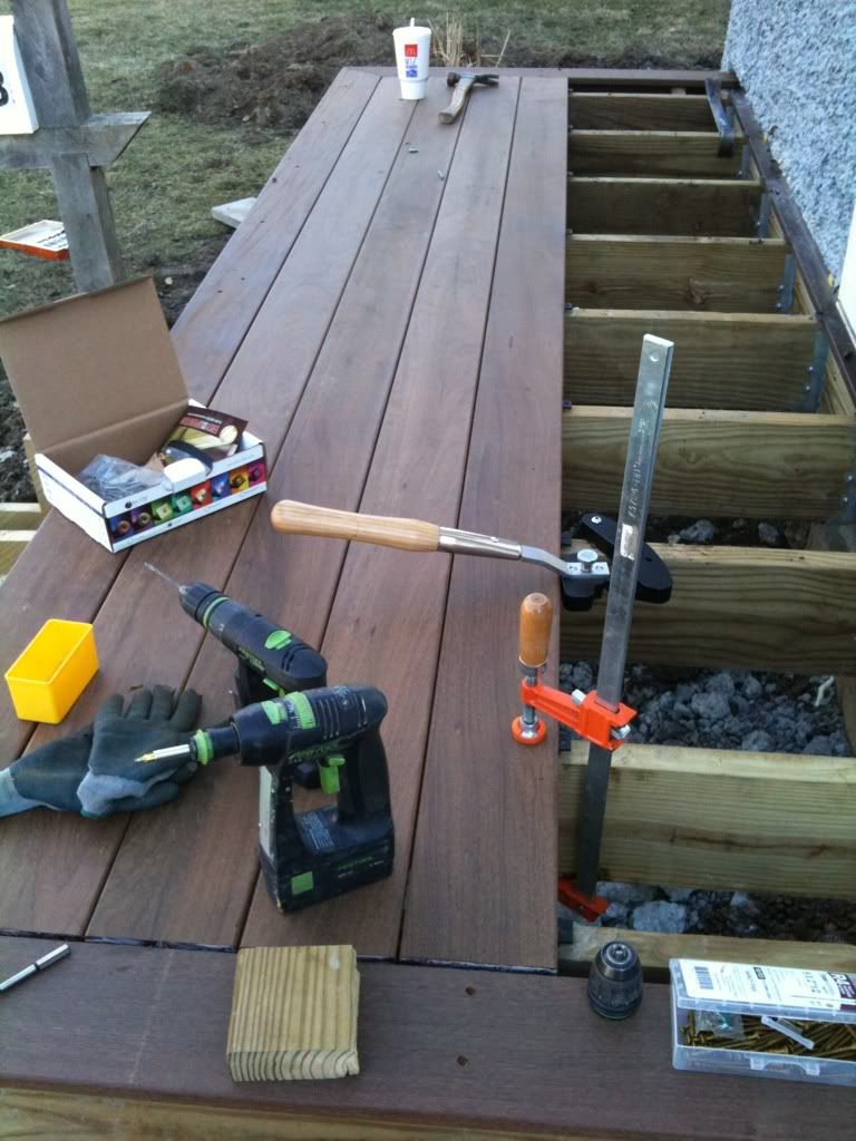

I've never seen that wrench thing for decking before that's a great tool, how did you fix the ipe boards down too the joists. Really nice work btw

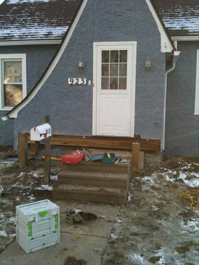

Pardon my ignorance, but can I ask why do you say "HO was smart enough to leave the front steps in place."  What would have been wrong with removing the old steps?

There are cheaper versions of that wrench out there.  I got this one for free, through my SA Hardwood supplier.  On that note, I would still fork over the 200.00 it costs.  It will last me a life time, all machined billet aluminum and a nice hardwood handle.
I order my decking in 3 variations, grooved both sides, grooved one side and no grooves.  You can't eliminate face screws in certain places, those get a plug and then sanded.  For the field boards, I have been using tiger claw hidden fasteners, but I decided to try something different this time.
I used these: http://www.ipeclip.com/ipeclipExtreme.html
It is an extra step pre-drilling each hole before running the screw in, but I like them.  Nice and solid. The tiger claws don't have the screw go through the deck board, just into the joist.
It was a way to prove to the BI and zoning department, where the foot print of the original porch was.
The set back is 50' from the center of the street, nothing can be built that encroaches that.
The front door is 1' over the set back.  See the issue?
The steps just showed where the old porch was (they were without a way to get in the front door for a couple months before I started the porch).

What kind of deck wrench is that?
It's a Hardwood Wrench
[smile]
Thanks for the link. I booked marked that for summer deck season in MN.
I made mine own from square tube stainless steel, i knew an excellent ss welder.  The original tool is bowrench.  They all work the same, bowrench is much less expensive then the one used here.  http://www.amazon.com/Cepco-Tool-BW-2-BoWrench-Decking/dp/B0000224UP

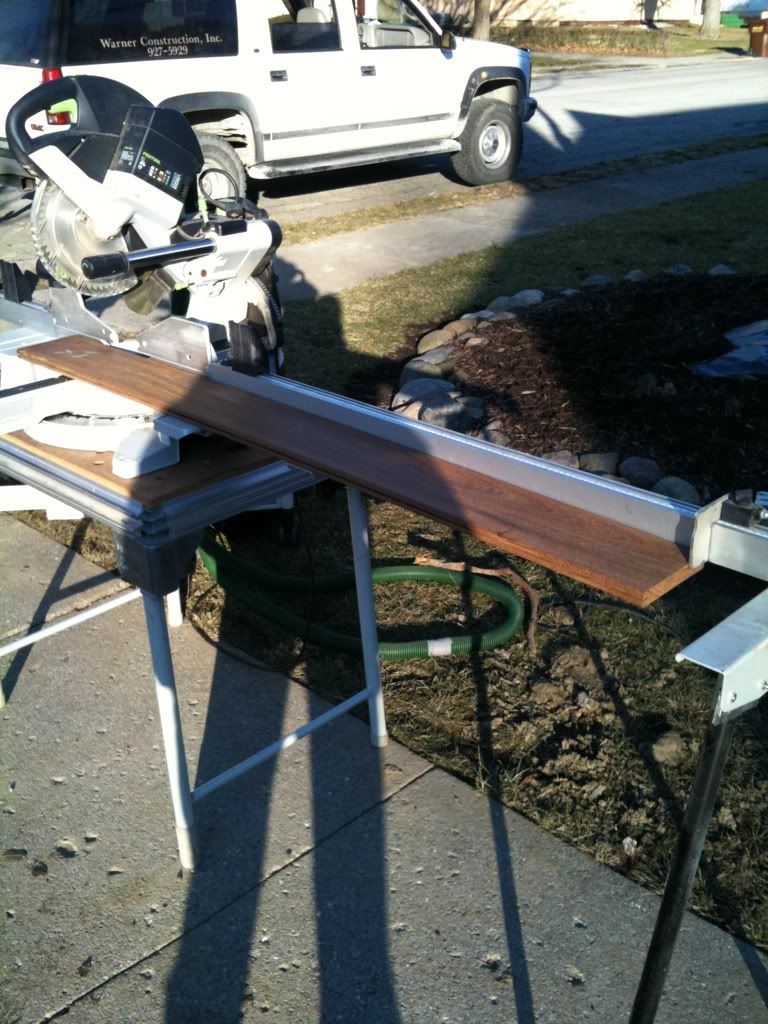

hey nice job and yep that is sucky weather. question... did you use any festools to build this?  [poke]
