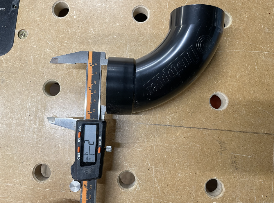

Take a look at this. It says 2-1/2" on their website but the hose port (female) measures 2-1/4" ID. I didn't take a picture of the male side, but it was 2-9/32 OD and fits into a vacuum dust port (mine is Fein but the size should be standard).
Thanks!  Just ordered 2 of them.
I received the elbows and they are just what I needed.  Thank you so much.  I searched and never ran into these on the interweb, so would never have found them on my own.  Thanks again!
