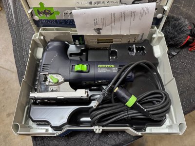

Like I mentioned, the PS 300 was manufactured in January 2012 and I purchased it February 2025. The dust collection nozzle was missing and I didn't catch it until I got home (the dealer I bought it from is about 1.5 hours away and in another state, so I wasn't keen on going back). I called FTCS and they were kind enough to send me a replacement. The only pic I have of it was when it arrived a week later. I don't know which version of the nozzle this is but it does have the facets for the current D27 hose.
