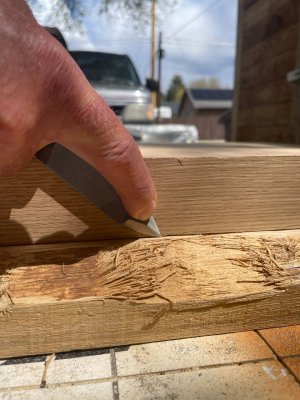

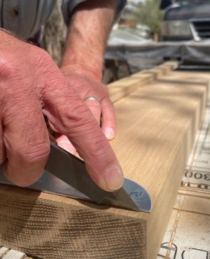

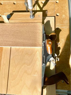

There were two personal projects this year where a marking knife was mandatory. I made a bed and a desk for my wife, both with White Oak. The bed and the desk are very simple designs, but, both required a lot of scoring across and with the grain. Scoring with the grain may just be the true test of a marking knife or marking gauge. I'd like to hear Dereks thoughts on marking with the grain, against a straight edge, what kind of knife, and what knife shape and bevel. Sometimes you can't fit a marking gauge, or the cut gets interrupted, and you have to connect the cuts with a straight edge. Derek, your Kinshiro cutting gauge is a thing of beauty, I will look for a replica.
The legs on the bed are a lap joint, cross grain scoring on an angle was important. The tapered legs of the desk had tenon turned on one end, I used a very sharp 1/8" parting knife to start the shoulder, but it required an aggressive cut with a marking knife first. Otherwise, the tear-out was crazy. I also knifed-in the stretchers on the underside of the desk. Hence, the question about knife type against a straight edge.
E.

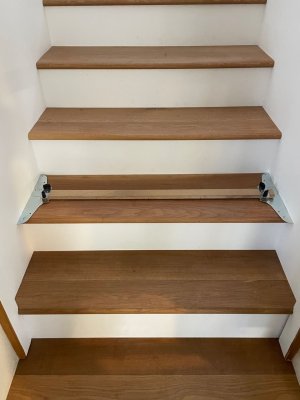

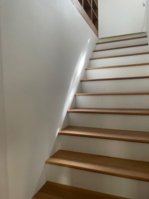

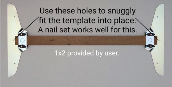

I'd almost forgotten the most knife intensive job of the year. This was a less than ideal stair tread install, in a perfect world, there would be a timber skirt that the treads would butt too. The previous owners of the house furred out the walls and cut sheetrock around each step, hiding the stringers. It was cost prohibitive to go deep enough to install a timber skirt. So, that meant cutting a piece of solid wood nosing, and one piece of engineered oak flooring that made up each tread and butting them against sheetrock. Enter the Collins Stair Tread Template. One of the best tools ever invented, simple and accurate. Cross grain cuts on white oak can be frustrating, as it will tear-out if you just look at it wrong. The flow was to transfer the template to the treads, lightly clamp the template to the tread, trace the template with a marking knife, cut to within 1/32" using a track saw, finish each cut on the shooting board. It sounds complicated, it wasn't, it went fast, and turned out well. Cutting against the metal template left a few dings on my marking knife, nothing a few passes on a diamond plate didn't remove.
E.

The early exacto knives, did hold the blade nice and firm. Somewhere along the way, they got cheaper and the first thing to notice was the sloppy blade in the knife. I used to make mine from an old warding file. Just need to be careful not to overheat while grinding. They hold a nice edge. I use single bevel and double bevel. For the double bevel, I grind the end away of the old exacto blades from modelling.
I really like what you have done, especially with the very nice handles. Makes the tools more fun to use.
Interesting. I had to look-up "warding file", I'll bet that made a nice blade. I may start there with the next marking knife. Once you get used to the file pattern under your finger, there's no goin back.

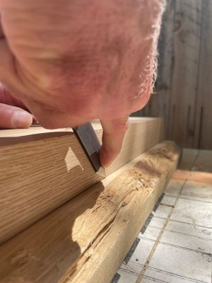

The first pass with a marking knife is super light, but not so light that the grain takes it. I wanted a blade long enough to trace 8/4 material without being tipped, and a wee shelf directly above the edge, so that on the second pass, I could really lean on it with my finger tip. Having a comfortable grip is nice if you're using it all day...
E.
