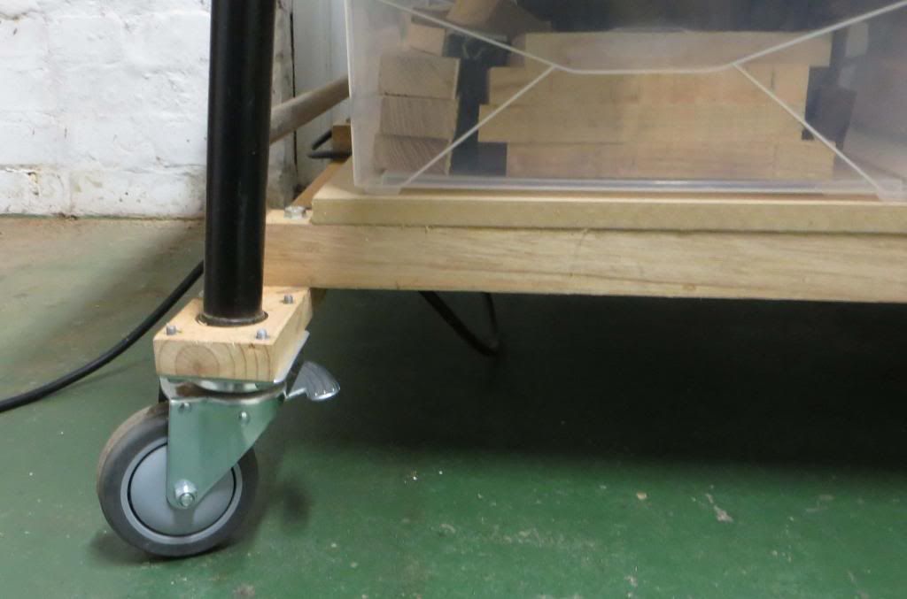

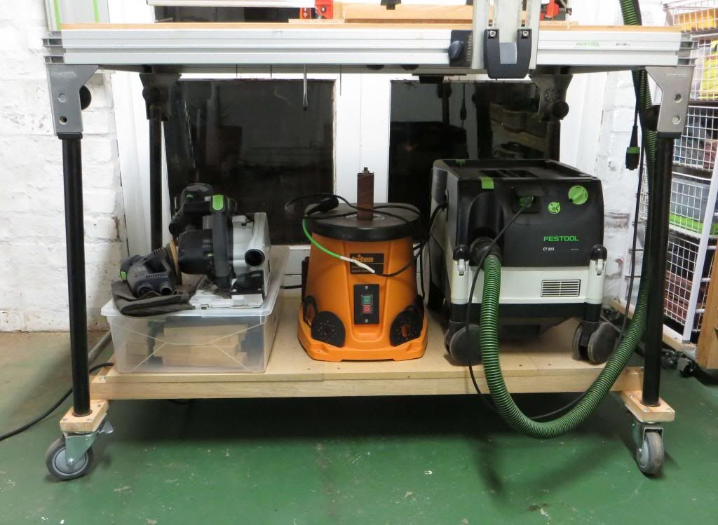

Rather rough and ready, but it works brilliantly.
I put mine on a sled after the first week of owning it. I made a two by four frame and then captured a piece of three quarter inch plywood into the two by four frame using dados for strength. The plywood makes a generous shelf to place things like systainers or other storage solutions underneath the MFT. I used three inch locking casters for stability whilst routing or using the track saw. I am very happy with my sled and it was easily made in an afternoon. As stated above more elaborate and yes quite beautiful sys ports have been made by fellow FOGGERS but for my humble needs the sled is just fine. Put it on casters, if you decide you do not like it then use the casters for something else!
[attachimg=#1]
End view of MFT Sled.
[attachimg=#2]
Another view of the caster set up for my MFT.
one thing i like about that sled is that the mft can be folded up and all your left with is a thin sled to store. the full scale sysport mft setups are great but take up a lot of room
