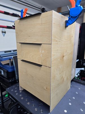

The fence is perpendicular to the track. So I slide the workpiece against the fence then I move it to the right so it goes under the track and then I set it to the proper size, say for example 200mm. Then I set my saw to a 45 degree angle and make the cut.
Take a look at the attached photo, I cut the side panels and drawer fronts using my Dashboard table/fence. Perfect miter edges.

Ironically your photo shows the drawer cabinet on an MFT table from Benchdogs UK‼️
You are fully embracing diversity of suppliers 😎
Yeah I have 2 tables, my Dashboard is used for all my rip cuts and wide cross cuts and my Benchdog Tools table is used for cross cuts only. Both have their advantages in my shop.
