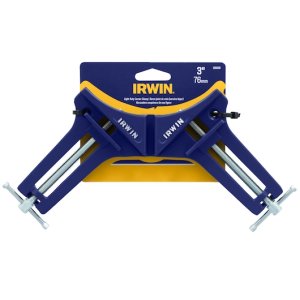

And I add these corner clamps. I probably have a dozen or more of these so I put them on each corner on both sides. But that is more than you need. Four is fine. I’m showing Irwin because they had the best image.
One on each side of one corner and one on each side of the diagonal corner. I always check diagonal dimensions but they are always on the mark with this technique. No need to buy premium clamps. Even the cheap ones work fine. I’m sure Pony and Bessey clamps are great, but the bargain ones from Harbor Freight or Amazon work fine too.

I have never gotten along with corner clamps for boxes (vertical use) they are fine for frames though.
I have gone whole hog into Bessey parallel clamps, but they are quite heavy and generally overkill for casual users.
As long as your joinery is tight, without a lot of pressure, even light duty aluminum bar clamps will do fine.

But the corner clamps have served me well. You need to lay a couple of 2” x 4”s to hold the box off the surface for clearance for the clamps. But other than that, easy.
4 clamps are enough, but 8 clamps really locks things in.
