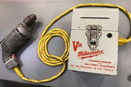

Hmmm, a 40 V sander...I wonder if it is lighter than my 36 V Stihl lawn mower? But wait, it's also corded at the same time...so it has the mobility of a Milwaukee "battery powered" drill released circa 1960...ya I'll purchase a couple off those nifty Makita items...😵‍💫
