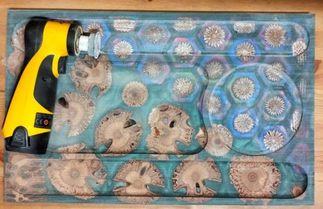

As I do a lot of resin sanding, this tends to wear out normal discs extremely fast, so I ended up trying the top 3 brands in all the grits, and I'm just blown away at how good they are, and how long they last.
And even when they're too worn for the sander, I still get months of use hand sanding edges and curves with them, and buffing finishes on with the higher grits.
To put it into perspective, using my flypress I punch out my own 35mm discs from Mirka Abranet Ace for my 32mm head mini sander, and a single disc will last for probably 3-4 of the boards pictured with especially aggressive sanding in the curves.
Conversely, the old 150mm media lasts pretty much one per board, so given I punch around 15 mini discs from a 150mm disc, the order of magnitude the mesh lasts is pretty astounding.
I have some teak sanding that needs to be done, I'll try the net abrasives on that. :) 3M is known for producing sandpaper sample packs and selling them at close to cost to get people hooked. Last year I ran across their Xtract sample packs and purchased a case of 5" and a case of 6" discs. They were basically free at 5¢ and 7¢ per sanding disc with free shipping. :love:
That board is pretty cool...:) ...are the pockets done with a router or a CNC?

For the charcuterie boards I was doing the pockets with a template and router at first, but found clamping them securely was a bit of a pain so I now do them with my CNC, much easier.

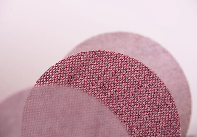

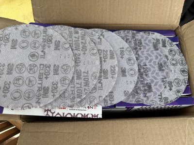

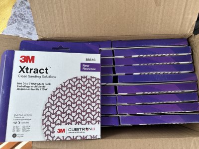

@luvmytoolz @Cheese I've got a mixture of Cubitron and Duragold. The Duragold is in a variety of grits, but mostly in the upper end automotive 1000s and no hole stick on paper for the blocks. The Cubitron is not the extract paper, it's got a weird water sprinkler pattern. tiny holes. I swear I'll use it up, hahaha! I haven't bought 6" any paper yet for the EC 150. Is there any Mirka or 3M paper you'd recommend? 3M seems fairly straightforward (and I'm already in love with it). Mirka has so many options named after locations in fantasy novels, I have no idea what the names mean.
@nockpoint Congrats on the 150/5, you'll love it. So far as media, if it's mainly wood the Mirka Abranet Ace would be my first choice, then Granat Net and then Cubitron 2, not that any are more inferior, just slightly different results depending on usage I've found. If you're doing a lot of polishing the Mirka Abralon up to 4000 grit is superb and cuts really well, it's also fantastic for buffing/rubbing in oil and wax finishes.
If doing grunt rough sanding work, the Mirka Abranet Ace HD cannot be beat, it is astoundingly aggressive and long lasting, but highest grit I think is 120.
This link describes the Mirka abrasives well, there is a new one touted to be one of the best yet by Mirka, "Ligno", but I haven't tried that one yet, but will soon:
