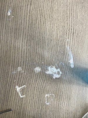

My oldest son has a model building hobby. He and his wife have a 1-1/2 year old son and he is at that super active age. My son had a model on the dining room table and he said for the past few days his wife has been telling him to move it somewhere else. You probably already know what I'm going to say, his son took a small bottle of acetone and spilled it on their very expensive wood dining room table. He told his wife and she said she didn't even want to talk about it!
I googled a little and find he is not the only one with an acetone issue on a table. Seems there are even experts that do such repairs (he is in the western suburbs of Chicago so if anyone knows of a reliable repair company please let me know). At first I was thinking we could do the repair but then he sends me a couple of pictures - attached. Sure looks like it was painted white then gray and then possibly a black stain on top?
Any repair help appreciated.

Mike, I would avoid sanding the top as it will lose its patina. Instead, use a card scraper to remove the marks and smooth down the surface around the marks. Not a sanding pad, unless it has a hard surface, otherwise it will create indents. Then touch up - to do this, experiment with finishes. You will likely need a touch of colouring to match the existing tones.

If that is a retail purchased table, in all likelihood the finish is lacquer. There are simple methods to test for finish type. Lacquer can be spot repaired, but the question is locally removing the damage, as @derekcohen pointed out.
Strip the remaining lacquer with acetone, carefully hand sand with 400 or and refinish with either Osmo or Rubio. Easier to fix any future issues that might arise. The original looks like a pickled finish, it’d be difficult to duplicate.

I would sand down to bare wood.
I would wipe on Seal Coat (acts as a primer)
I would wipe on 4 to 6 coats of oil based poly (gloss).
If it is too shiny for you, than use some 0000 steel wool and rub it out with either butchers’ wax or “wool oil”. The butchers was can make re-finishing difficult in the future, but looks and feels really nice.
The wool oil is not supposed to affect later applications of finish (I have not tested that claim).
I get a more uniform and nicer result applying wipe on finishes. But brush on or spray would be fine too. Only oil based finishes are suited to wipe on application.
Hard to tell for sure but:

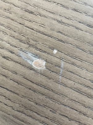

• Looks like the acetone has already removed some of the patina/stain in spots (2nd photo).
• Hard to know what the finish is. Lacquer or polyurethane or any of the newer who-knows-what catalizing finishes?
• If the finish softens with alcohol (or lacquer thinner) then it's probably lacquer.
• Given the acetone has already removed some patina/stain, you're either trying to spot repair the color and then re-coat or remove all and totally refinish.

Spot repairs on wear surfaces will never survive. Even if it is made to look perfect, at the time, it will not age the same as the rest. It could go either way though. The rest of the table may continue to fade, and the stained area doesn't or the opposite. The stained area might fade, leaving the rest of it behind.
Strip and refinish the whole thing to allow it to age equally.....or get over it?

“The whole thing”? You don’t think he can get by with just refinishing the top surface? The top of a table gets more light, and even if it was all original, the top would look slightly different from the legs and skirts.
I would try just the top. It is a lot of area, but it will sand fast and it is easy to finish horizontal surfaces. Horizontal surfaces get more abuse and I always add additional coats for that reason.

I contacted Thomas. He said he doesn't think there is a way to repair the spots - it needs the entire top refinished. He said his brother could do this but would need to ship the top to him. Like we were thinking he suggested to contact the store and manufacturer to see if they could help.
