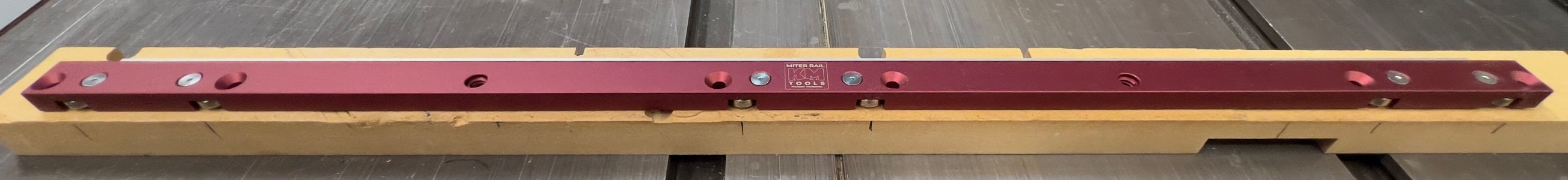

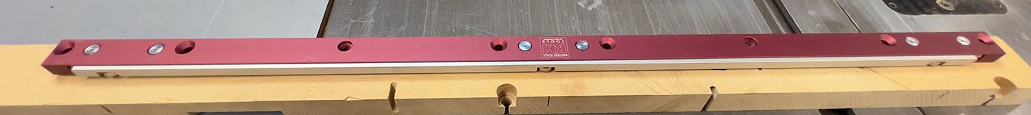

Here are some photos. Basically, the body (in red) has 3 sets of 2 ball-bearings. Then there's a sub-piece (silver) that has 3 ball bearings, each one located in between the set of 2 on the other side of the bar.

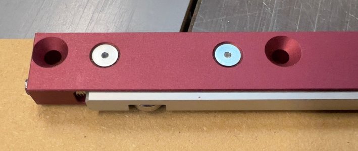

There are grub screws at each end of the bar that you adjust (push-pull) that moves the silver bar fore-after in angled slots so the silver bar also moves in/out, thus changing the width.
In his product video (link), he shows his sled sliding really easily on his table. I found that while I could get a no-perceptible wiggle adjustment on my saw or I could get the bar to continue to slide after I stopped pushing it, I couldn't have both - if the bar was adjusted to no wiggle then it was too tight to just keep going. That said, this wasn't my expectation for this anyway, and I found I could tweak the width to get a no-wiggle fit with enough smoothness that pushing it wasn't an issue, and that it was easier to push than the adjustable bars with the circles.
I was a bit concerned that with the adjustment being for the whole bar that my slot might have worn over the decades to be a tad wider in the front than in the back and so there might be some fit/wiggle concerns, but that doesn't appear to be an issue for me so far.
Perhaps the biggest issue, for me anyway, is the shortish length combined with effectively having just 3 points of contact. A bit more than half the bar has to be the slot for any kind of accuracy. So, at a 20" length you need at least 11" of bar in the table, so you've got only about 8" or so of bar beyond the front of your table to your raised blade. For "normal" sized cross-cutting this is probably fine, but this wouldn't be my choice for a wide stock cross-cut sled. That said, he does sell a slightly cheaper 8" long version, and perhaps one could combine two of those in a line, or stack the 8" with the 20". But, that gets expensive and alignment might be tricky.
One really clever aspect is that the bar is fitted with a number of very pointy grub screws (more like tacks) that are threaded into the bar so you can remove them, but they enable you to put the bar in the slot and press down on your sled base to stick/align them. The tacks hold well enough in plywood and MDF that you can then lift the base up with the bar attached, and then screw up/down as desired.
Overall, I give this a thumbs up. It's not cheap, but it appears well made and does what it needs to. Unlike the plastic circle adjustable bars, this shouldn't wear out quickly, and unlike wood runners it won't expand/contract with humidity.

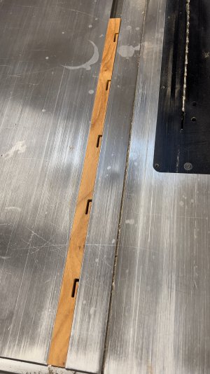

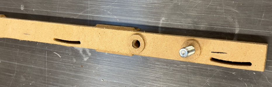

As a side note, I've been spending some of my spare hours in the shop working on a CNC'd miter bar that uses the compressibility/springability of wood/phenolic to self-compensate for wear. This came from my YARSB (Yet Another Router Sub-Base) effort where I made a phenolic attachment to ride in the groove of a track saw track:

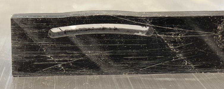

My design uses the compressibility of phenolic or wood to enable a single piece bar with a spring mechanism, which started out like this:
But is now this;
I figured wood or phenolic slides in long length would be too flexible. Does the Inca have two miter slots?

I did make a miter bar for my Inca miter gauge head out of phenolic, and yeah, it's flimsy when not fully in the slot. But, for miter gauge use I'm not cutting wide stuff and with the miter gauge you want the head and fence supported by the table anyway, so it's for not-wide stock and is OK. That said, I did splurge and buy some Argentinian Lignum Vitae and made a bar and it's pretty rigid - not as rigid as aluminum, but rigid enough that I had to modify my spring dimensions since I could barely push the bar through using the same interference fits as the phenolic that slid very smoothly.
But, while a miter gauge bar probably should be rigid, bars attached to the underside of sleds are supported and don't have to be rigid at all.
