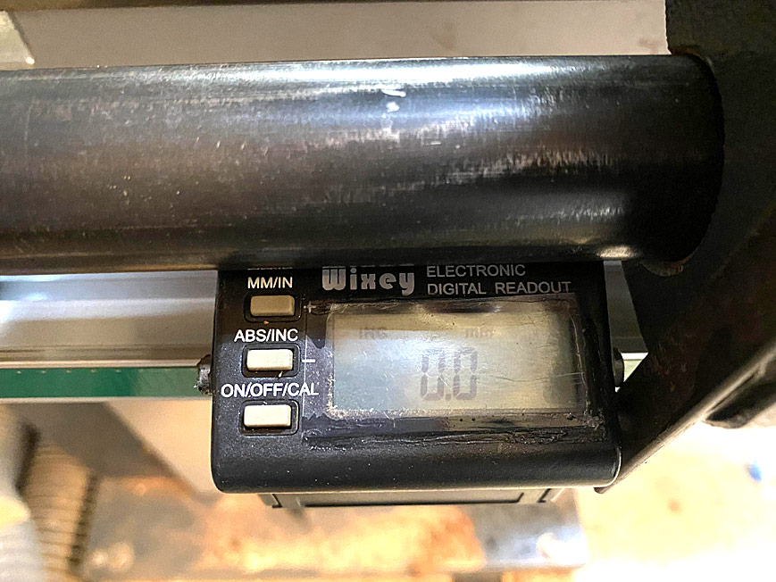

Matt, as I mentioned, I really liked this idea. I do not know why I did not think of it, because I have a spare Wixey for the table saw ... well, part of one: there was a small section of rail over from a previous installation, and then I replaced the digital box as the original had been damaged (lost the window, which I repaired with film), stopped working (although I later learned how to work around this, and now it seemed fine). In the meantime, the one on the table saw (Hammer K3 slider) looks nice and new :)
My thought was to build it in using the same method I used for the K3. This is what I came up with ..
The control box is attached with a rare earth magnet, so it can be removed.
The only issue with the gauge is that it attaches here from the left side of the fence, where it is designed to attach from the right (perhaps someone knows how to set this up for the other way around). The result is that the readout reads as a minus.
It sets up easily for zero, and this is important when changing blades.
Below is how it attaches to the Hammer N4400. I made use of the bolts attaching the fence rail. I am sure that other bandsaws will have something similar to use. The L-brackets were cut to length and drilled to suit this set up.
[member=4358]derekcohen[/member] awesome! thanks so much for your sweet setup, it looks great and I might steal some ideas from it!
Matt
Hi Matt
This set up is working very well - accurate to within 0.1mm! (to return to the same setting).
The only issue is that it reads as a minus. I don't know how to get around this.
At the blade ...
Moved back 40mm ...
This is the connection: rare earth magnet epoxied to the gauge, and mild steel epoxied to the fence lock ...
Derek,
I have a Wixey on my drill press and it does the same thing, reads minus.  I contacted Wixey, Barry Wixey responded that there wasn't a way to change the negative sign.  In the case of the drill press gauge,  he said that down into a hole is negative and up above the work piece is positive.
Would be nice if it was changeable, but overall a small problem.
Bob
