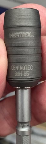

As mentioned above the Forstner bits in the set are new, and don't have a replaceable central pin.
The driver is labelled BHM-65, I can't see it as a separate part.
