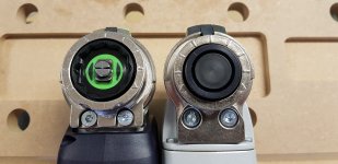

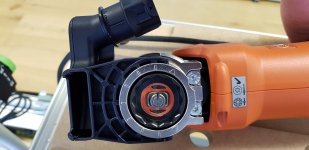

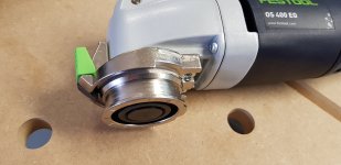

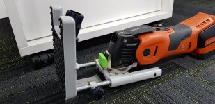

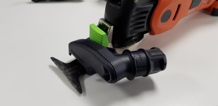

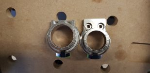

Right here goes...had a bit of a play today... 8) :
You CAN fit the New Starlock Vecturo accessory mount to the Starlock Supercut.
You CANNOT fit the NEW Vecturo accessories to the OLD Vecturo mount.
You CAN actually fit the NEW Vecturo Mount to the OLD vecturo BUT it does not allow correct operation, so do NOT do this, we only performed a test.
We presume the same goes for the old supercut but we do not have a machine to test.
You CAN fit the NEW Vecturo mount to the Starlock Multimaster BUT the Multimaster is only rated to Starlock plus so not recommended.
DISCLAIMER, these tests were just to see if things physically fit we haven't carried out extensive testing , please follow manufacturers instructions at all times to avoid voiding the warranty.
Hope this helps folks! [smile]
Few Pics below.

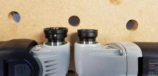

I'm curious what you mean by that? In what way is the operation impeded?
Little hard to explain..
But the new collet or adaptor is too deep hence the the blade doesn't seat correctly.
on the new Vecturo the tool holder is deeper.
pics below. Hopefully makes sense.
Thanks...so when you put the blade in, the blade probably contacts the new adapter?
[member=34503]Havwoods Accessories Ltd[/member] - Could you please expand on your statement: "You CAN fit the NEW Vecturo mount to the Starlock Multimaster BUT the Multimaster is only rated to Starlock plus so not recommended." I'm not sure what you mean by these machine's respective "ratings" and how this effects their use in conjunction with the new dust collection accessories.
I own a 350QSL and would like to be able to purchase and utilize the OSC accessories since FEIN doesn't currently supply (and has never supplied) 'bladed' dust collection for the MM.
I look forward to your reply. Also, feel free to PM me with your answer if youvre not comfortable sharing it publicly.
