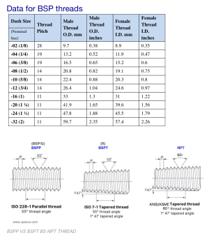

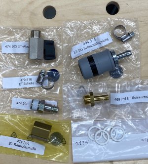

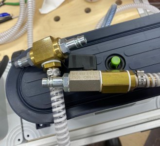

FWIW...the Vac Sys came from Festool with both BSP & BSPP fittings. This cheat sheet helped me out a lot.
Here are some new Vac Sys fittings ordered from Festool, however once assembled, it's easy to identify the BSP vs the BSPP fittings.
