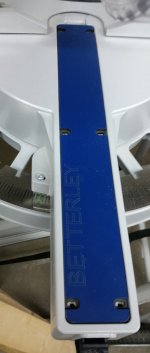

I finally had some time to play with both Betterley and Colliflower.  A lot of positives for both of them.  The Betterley has a more substantial feel due to the material used.  The Colliflower base is substantial and well designed, the inserts are a little cheap feeling but for $9.99 you get 4 replacements which can take you through a few different bevel cuts.  Both sit flush or a little below the saw bed which was good.  You do have to remove/reapply the screws for both so no advantages.  The Blue Betterley looks great on the saw but does not cover as completely as Colliflower does.  I will try to show pictures of both as well as how the replacement insert fits.
Take a look how Colliflower covers more of the back of the trough.  I would recommend either to replace what comes with the saw.

Is the Colliflower insert flexible enough that you could tilt the Kapex over to say 40 degrees and then remove the insert from the rear of the aluminum frame?
It is by flexible. Moving the saw sideways does not change the issue that the back base is in the way to slide in the insert...

I agree with you. It all depends upon how flexible the insert is, and that is what I don't know. There is almost 5.5" of distance between the end of the Kapex insert and the front of the structure the trunion is attached to. I can take a 12" flexible Starrett stainless scale (C305R) and place it in the position of the kerf insert and by pivoting the Kapex off to the side, I can easily slide the Starrett scale out-of & in-to the kerf insert position. Just another project I guess [eek]
My concern about a replace-from-the-back insert would be that it would need a very strong retention mechanism or the spinning blade will just shoot it out the back.
Just to clarify, my thought was to slide it in and out from the front.
Cheers. Bryan.
It is very flexible. U can bend it around intop a horseshoe and no issues. problem is the back base and the dust chute is interfering. The insert is a tight fit and you need to align it perfectly with the tongue and groove to slide it in. A lot of pressure with the bending makes that very challenging..... I tried....
Not trying to be adversarial but what exactly is the big issue with removing the screws? It isn't exactly a major feat of engineering.
(a) convenience and (b) I would be concerned about stripping/damaging the screw holes/threads over time....
Actually, now while I am thinking about it if you cut away a small top portion of the tongue and groove part like an 1/8th of an inch that might give you enough bottom support to slide in the bend insert.... I look at that tonight....
There's no issue. It's just a matter of refining an already good idea.  [smile]
In my mind, if the plate had a T&G access slot on the top at the very front edge which would allow you to slide in the flexible insert, it would be perfect.
