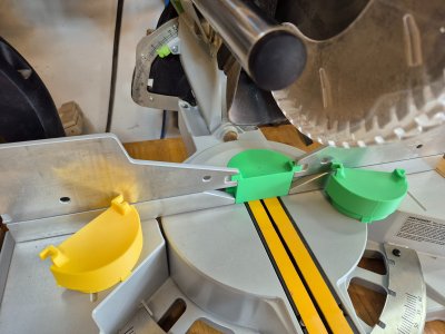

Thought I'd share a new, simple "zero clearance insert block" for the Festool Kapex KS 120 EB. I remixed this from Dudadz3d's original model that fits the Kapex KS 120 REB.
Why is this cool?
  • Doesn't require any modifications to the Kapex original fence
  • Doesn't require an auxiliary fence and its drawbacks (thicker auxiliary fences interfere with the Kapex swiveling clamps)
  • Is easy to install and remove, and retains an exact position when re-installed
Download and print your own:
Just be sure to check the model of your Kapex before printing. We discovered the fences are slightly different between the REB and EB models (specifically, the "ear" locations).

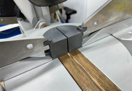

I found someone who would make the zci block for me with his 3d printer -- for $10 Cdn. It's a much better deal than trying to make one myself out of wood!

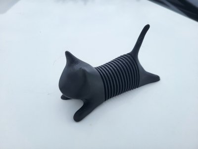

Thanks to Ryanjg, I now have three ZCIs (yellow one a prototype). I just learned that the 3D-printer owner started having his printer last Christmas and has been making many many things, such as the little springy cat.
Nice! Yep, I've been finding a lot of excuses for 3D printing. Those blocks look great.

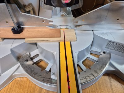

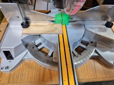

Today, I had the first chance to try the Zci block (as well as the silencer blade). The cut was clean and there wasn't any chip-out at the back, so the block worked very well as designed. If you're looking for a 90* cut zci block for your Kapex, this is a great option.
However, as expected, the dust collection did suffer a bit as compared to not using the block, as shown in the photos.
So, I will use the block when I need perfect cuts; for ordinary stock preparation, I'll make cuts without it.
