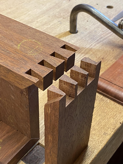

The construction of the box is mainly mitred through dovetails - all lower corners and the end upper corners. This makes it easier to plough through grooves for the base and top. The mitred corners are also, in my view, far more aesthetic, lending a balanced presentation from the top.
