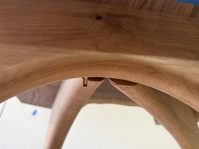

I made templates to guide me in cutting the curves. They are not perfect, but I will be the only person to likely notice. Today while doing the round over, I forgot to tape off the area where the back legs join the front. So not only did I expose a poorly placed domino, the legs do not meet correctly. I am probably going to glue it and then sand the mismatch the best I can to blend it. It will only be visible if you are laying on the floor, but it will bug me. I considered shortening the rear legs to where the curve would come down the match the front, but I am not sure how well that will work out and may make it worse if I mess up again. I will putty over the domino to hide it. Hopefully. Any other suggestions on how to fix it?

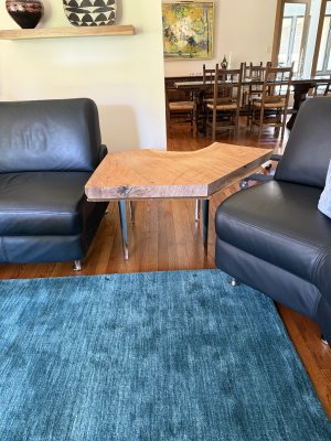

Temporary placement to get my wife’s approval.

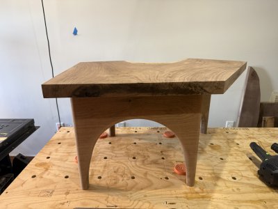

Dry fit. Time to sand.
