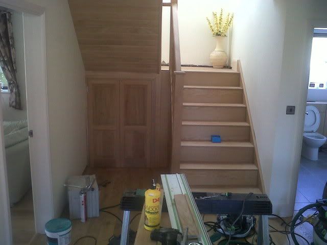

didnt make them but fitted them.
Dean
Why didn't you give me the chance to make them for you  [poke]

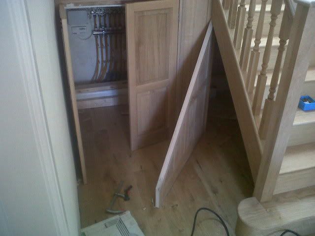

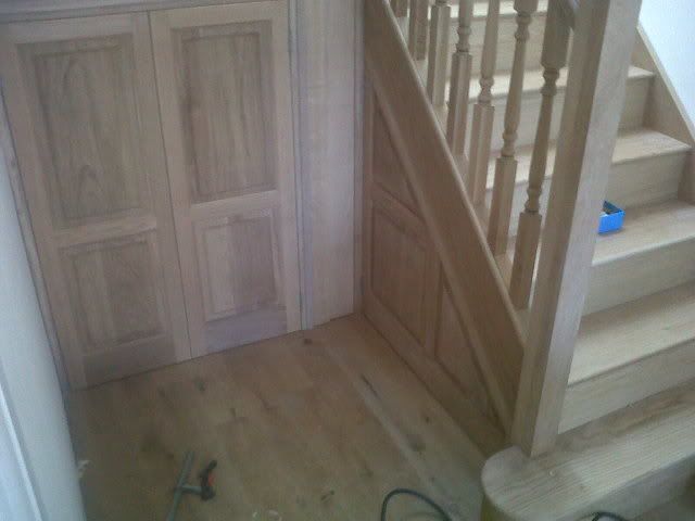

I like the angled door under the stair, did you make it ?  The treads look quite thin, about 25mm possibly ?  I always make mine 33mm.
Good to see some of your work at last  [big grin]

no i didn't make it, That angled door was suppose to be fixed but i decided it was a waste of space.
Treads finnish 22mm i think but have 4 glue blocks and 2 large triangular supports under them.
33mm solid oak treads? really?
FOOTSTOOL IS A WOMAN  [scared] [ban]  lol
Dean, always make my stringers & treads 33mm thick.  Risers usually 12mm oak mdf but sometimes 18mm solid oak.  Always fit 4 glue blocks to every tread also.
I like the hinged door, gonna borrow that one  ;D

if you do a triangle door it has to have a small flat section on top to be able to open

The thicker treads really makes for a quality stair.  Ive seen the 25mm ones & not keen on them at all.  Blooming heavy when it comes to fitting though  [sad]

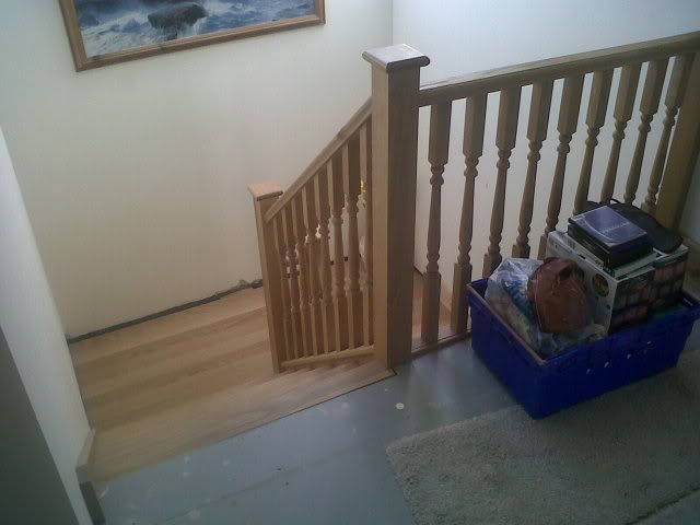

One thing i notice is the top nosing is flush with the chipboard.  I presume the carpet is going to tuck around it.  I sometimes have the top nosing up by 15mm or so to allow the carpet & underlay to be just above the tread.  Makes for quite a nice look but not everyone likes it like that.  I always give the choice.

yeah i know what you mean, 1 prob with that is the landing wont get carpeted till about christmas and would make a nasty trip
