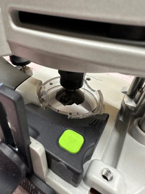

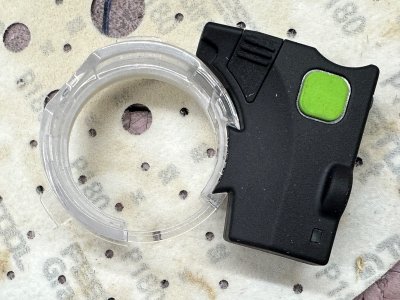

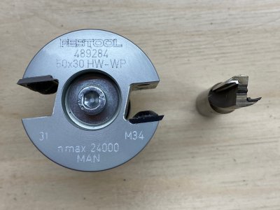

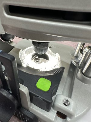

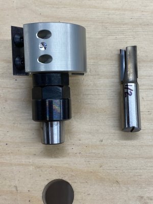

Like others have mentioned, the 1010 is an absolute dream to use, the 1400 is real nice but the 1010 hits the sweet spot. And with the recent availability of 8mm router bits, it can handle just about anything. As an example, here's a rabbiting head for the 1010 compared to a standard 1/2" router bit.
Also consider that the new 1010 REBQ router has an LED light module available.
