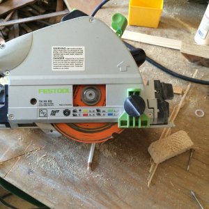

Until things change, I'll continue to use this blade in either a TSC or HKC saw.

Many told me Festool would not honor the warranty if there was a failure, didn’t matter to them what the materials cut list said. I would wipe the track and baseplate off once done. Don’t tell anyone but I use the CMT TS 75 blade in my Kapex for cross cuts. .
That blade looks familiar.

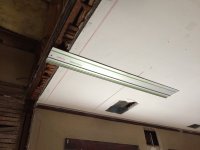

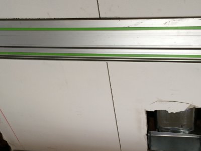

Ceiling mounted…

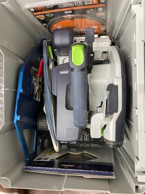

Ever one of them goes back into the Systainer, blown off, and ready for the next time.
Tom, that looks to be the perfect situation for the KP rails.

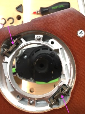

If using with a dovetail jig (the Leigh one is the one i use) there is too much play on the 1400 collets, so it might not stay consistent with your dovetail cuts. 1010 I don't think i had that issue at all with the jig.
The collets are not the problem, it's the way the copy ring is attached to the router that's the issue. On a 1010, the copy ring is screwed directly to the base, on the 1400 the copy ring is slid into a retainer that is secured with springs. The springs stretch/move and thus allow the copy ring to move. Also unfortunately, the 1400 copy ring moves a different distance depending on where the force is being applied. :mad::mad::mad:
Here's a photo of the retainer mechanism on the 1400.
The "play" is pretty easy to fix, it's the "maybe off-center" part that people have issues with.
To tighten up the bushing, just bend the clip tangs out slightly. Don't go to crazy, or it gets hard to remove them.
The OF101 is still far better, in that respect. If you use guide bushings a lot, it's the one to have.
