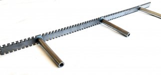

A lot of good ideas here. Those striplox would work on the wall, then you could do a groove on the bottom and simply drop the slab in place.
I was thinking of the metal pipes as used by floating shelves and shown above with a hidden dovetail on the bottom. Slide on the dovetail and into the pipes. A large GRK screw/ lag on an angle at the top to hold it from sliding out until you need it to be moved. Only damage would be to the wall and the dovetail strip on the floor.

I'd consider using one of those heavy duty hidden shelf brackets down the wall and then lagging in the bottom edge of the slab through the floor from the crawl space.
https://www.etsy.com/listing/678646...MIwuHP9aum5gIViobACh1AdgCdEAQYASABEgIWwfD_BwE
