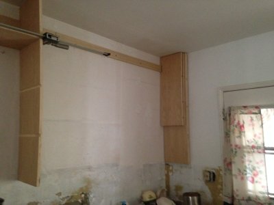

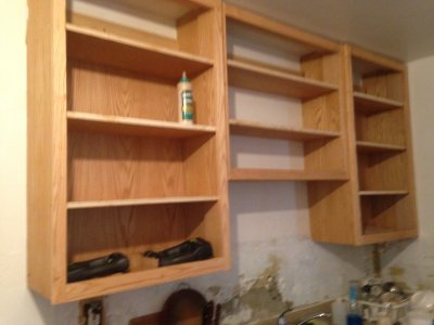

I installed the plywood boxes in the photo below using French cleats in 1978. It was a pain to get them all level for two reasons. First the walls were not perfect so many wall cleats had to be shimmed so the box cleat could fully engage. Second the spacing was too great to use a bubble level between cleats and also too great to use string since it sagged. Had to use the ancient water level technique but it worked.
The boxes were made for the artist by Peter Ballantine. A phenomenal craftsman.
