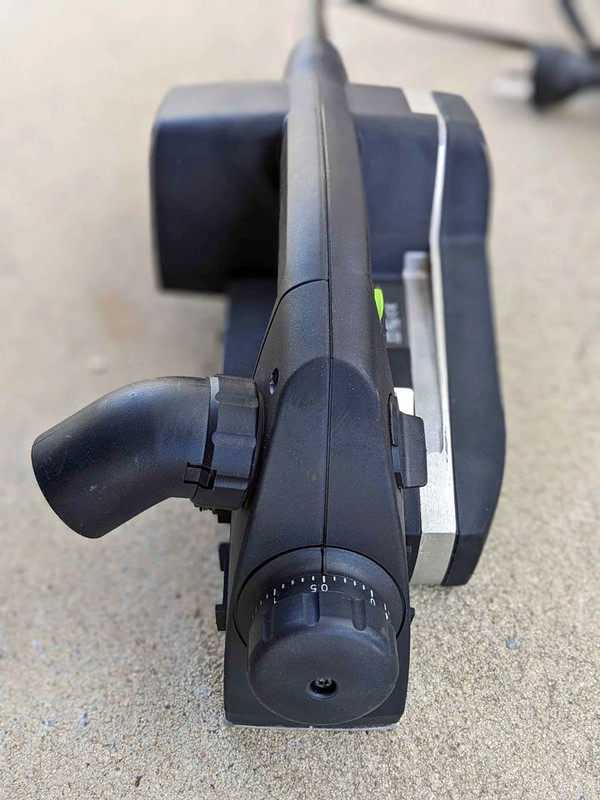

I picked up the EHL 65E planer yesterday. It looked like new, with little use. Built in 2001? I doubt it - I imagine that was when it was first produced. It has a fixed cable, which likely places the build before 2017, or there abouts. The cable is not an issue for me - I was really trying to gauge the build date.
I suppose another way might be to look at the style of the Systainer. The one the planer came in has the old style clips.

Photos of the plane ..
That looks like 2001 is the build date Derek, the case backs that up by the look. I have the HL850 and it's superb so you'll love this one.

That 2001 is a build date, not a first introduction date, so it is that old. Shouldn't hurt anything though.
I ran the planer yesterday on some rough sawn roof rafters. It cut well but ploughed deeper than I would have liked. Today I cleaned the planer, especially the housing for the blade, loaded up a new blade - the old one was really dull - and planed down a wide slab for a friend. It was possible to go from whisper shaving to deep. Not bad at all.
