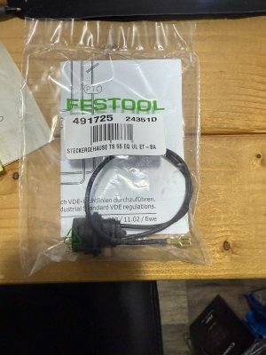

TS60 110volt in the US. Plug-it installed

Any updates on this? any issues?
I have a dewalt flexvolt track saw....LOVE IT.....but - stupid power cord from my dust extractor drags everywhere when trying to use it.....
Options;
Buy a TS55 and get the TS60 adapter for dust extraction (less angle) and forgo the brushless (hard pill to swallow) Only my Domino is brushed - everything else is brushless
Buy a TS60 and convert it to the high amp plug it - if warranty was a concern swapping it back is like a 3 minute swaperooski and voila - can't even tell - I get to stay brushless
Obviously the TS55 is significantly cheaper - and I could always buy the TS60 from recon, as that only has a 1 yr warranty, so I get a hefty discount and giving up less for the conversion.
My dust extractor has the plug it cord permanently attached to the hose
I work inside 99.999% of the time, so dust extraction is always used
without the plug it, I will just keep my DeWalt - it works great and no reason to get rid of it other than the stupid cord dangling and getting in the way
After more than 2 years of everyday use, I can say it has been fantastic.
However, I was wrong in my original assessment. The TS60 did replace my TS55 as my main saw. I did keep the TS55 as essentially a dedicated Solid Surface saw. I keep a zero-rake triple-chip blade on it, for just that.

1. I care because I don't want a tool with a cord - corded tools are ok - see answer #2
2. My dust extractor doesn't move,but there is a "plug-it" cord permanently attached to my dust extractor HOSE - which when plugged into and powering a dimono or sander isn't in the way. When I use my battery powered track saw the "plug-it" portion hangs down and drags on my work, generally gets in the way. It would take ke quite a while to remove it and put it back, so i leave it and typically tape it to the hose temporarily.
BUT
If I could get a track saw that just had a plug-it connection - then i would just plug in the "plug-it" cord and no more dragging. TS55 is nice and would work, but TS60 is also nice - has a brushless motor, which is much smaller and the cradle is much more robust - has 2 leveling feet for 90deg cuts etc - I ould just have to convert it to plug-it" or I would have 2 cords dangling and would be twice as frustrated as now
