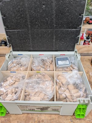

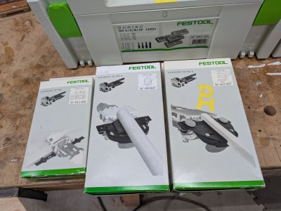

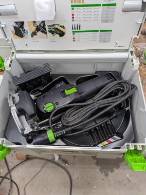

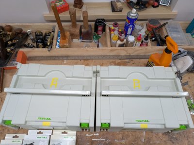

I'm looking for help pricing an older but never used Domino DF 500. I bought it and accompanying tenon and cutter kit and a few attachments as part of an estate sale lot of Festool goodies. I already have a Domino so I'm going to sell this one. I'm a little unsure of how it should be priced because it's older. I'm unsure of the age, but it has the old style Systainers. I'm also a little unsure of how much to discount the price because the previous owner labeled the Sustainers with his initials and color (bright yellow). Thankfully I was able to remove the paint from the tool and cord, but I'm afraid that anything that would dissolve the paint would damage the ABS boxes. I'm thinking $900 for the lot, but not sure how to price given the age and defaced Systainers. Any help would be appreciated. Thanks. 1000004838.jpg1000004831.jpg1000004833.jpg1000004836.jpg

If it's a very old DF500 it might have the slipping/misaligned fence issue, which might possibly present an issue selling it for what you want. Others will likely chime in but I'll see if I can find the original thread.

This DF500, looks to being the same with the metal pins, Picture on the systainer is showing metal pins, and the most likely slipping fence model. It looks like the one with the slipping fence to me.

The picture in the systainer lid shows the old metal pins. (I would hope they fixed the picture when they switched to the paddles, but maybe not).

Citrus degreaser and some mild abrasive fibertex likely would safely remove the paint.
