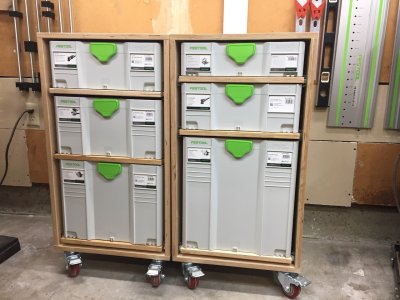

I built two systainer cabinets from the TSO plans. I am not aware of any software to calculate the spacing.
What I did was to build the cabinets, then place the systainers in the cabinet with spacers and figured out which to put the drawers in. This allowed me to try several different combinations.

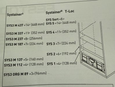

Thank you for the responses. Another question I have is on the instruction sheet that came with the AZ drawers. There is a picture in the upper left corner that lists systainer measurements next to a cabinet. Next to each named systainer is the systainer height (example 112) with a + 4 and a symbol after it. Anyone know what that symbol means?
Thank you so much. That finally makes sense.
