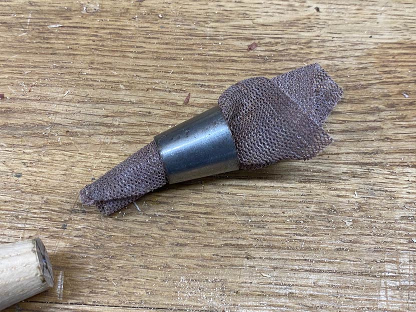

Next, clean the inside of the ferrule. It is rusty.
It needs to slip on firmly, and sit flush with the end of the tenon ...

After 30 years, the ferrule has been hammered and has flat spots. These need to be removed otherwise it will not fit over the end of the handle. I used a knife to scrape the inside of the band ...
