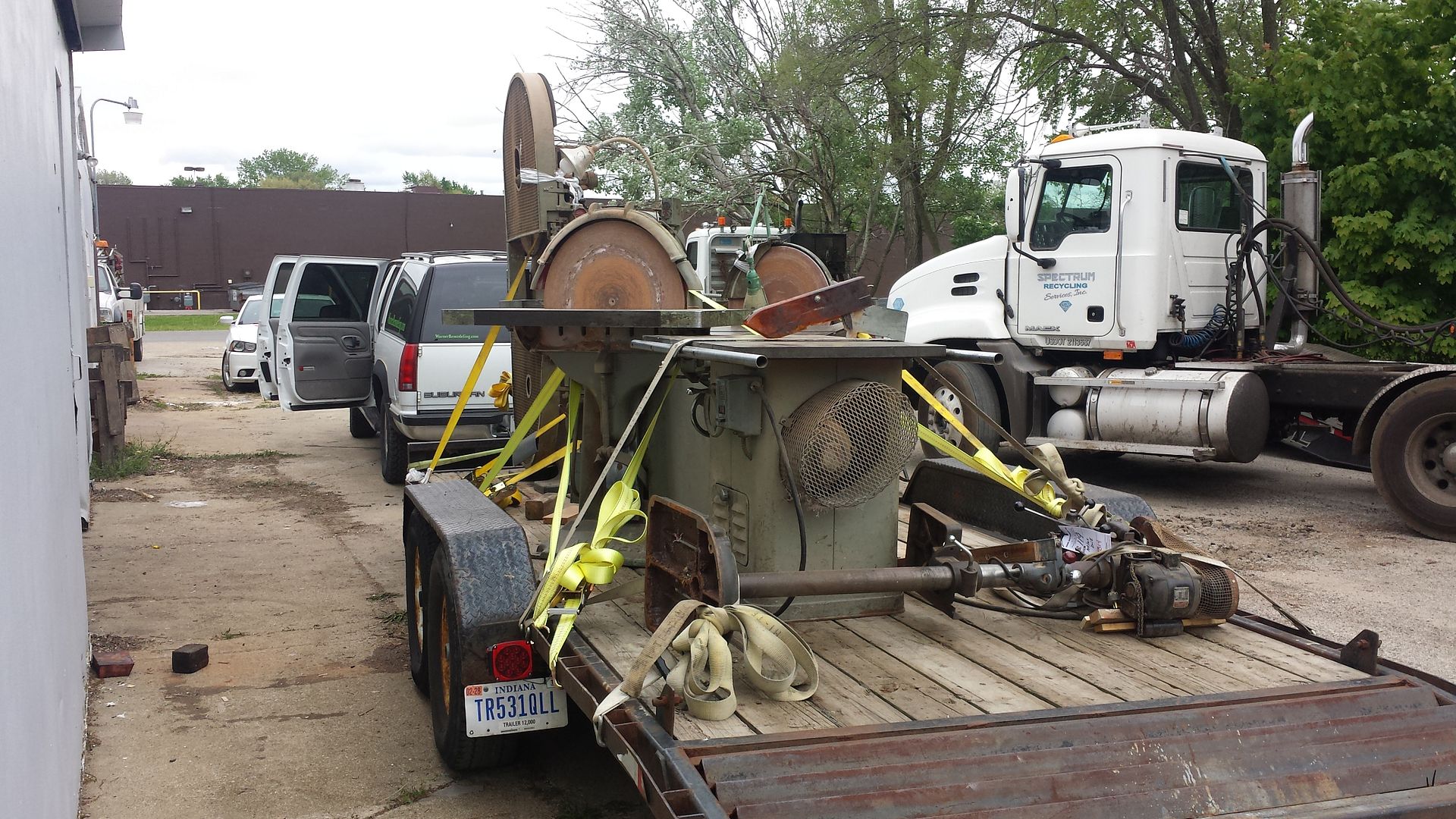

Had to go help pick up a few things today.  Sanders, saws, drills and such.
Here is one that I have a couple questions about.
I also got the miter gauge for it.
What is the best way to attach the paper to the disc?
What grit seems to be a good one to leave on (assuming changing paper is not a quick process) 100, 120?
