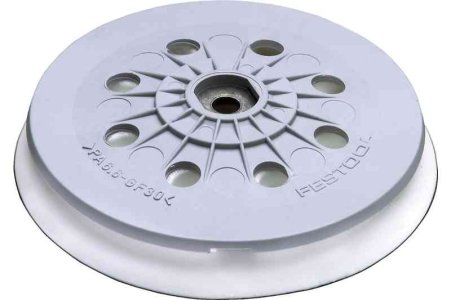

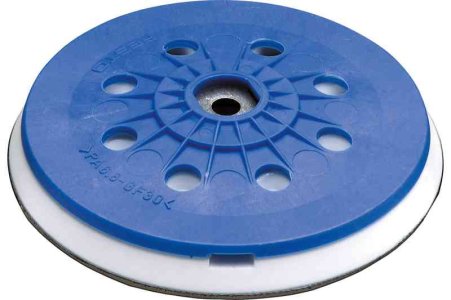

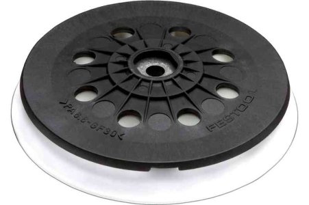

Just to prevent any further confusion when looking for the pads on the Festool website, Festool refers to the pads as super soft...soft and hard.

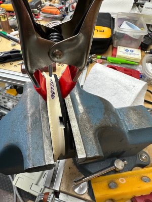

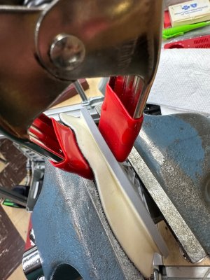

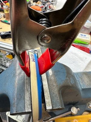

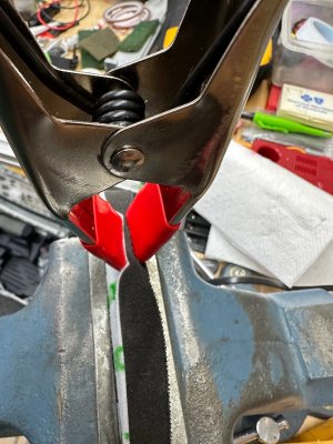

If what you're asking is to compare the density of the Super Soft pad to the density of the Interface pad...it isn't even close. The Super Soft is 5-10 times more dense than the Interface pad, compare photos 3 & 4. Here's a comparison of the 3 pad options for the ETSC 2 125.
A Bessey spring clamp is placed in approximately the same area on each pad. The 4th photo is an interface pad and you can see that it's completely compressed by the spring clamp.

Thanks! I appreciate the demonstration pics!
