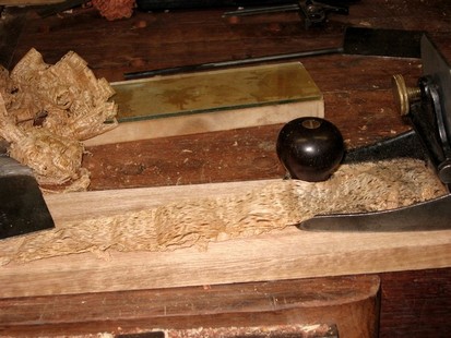

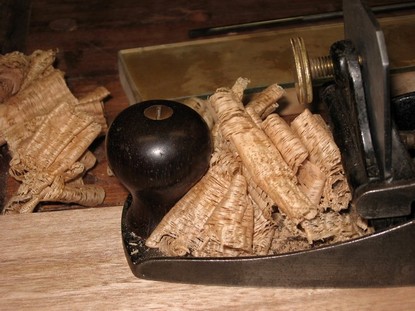

I don't know about any one of those, I have a Luben 112 scraper plane, a copy of a Stanley No 80 scraper, a Veritas cabinet scraper and holder and an Ulmia toothing plane.with Lignum sole.
I've not bothered putting a hook on the blades for the 112 or the 80 and they don't seem too fussy about it. Just a 45 degree sharp angle has been pretty good so far.
The cabinet scraper needs the hook and maybe I'm doing it wrong but the hook doesn't seem to last well.
The Ulmia toothing plane I sharpen to a 30 degree angle, it leaves a toothed finish, goes across the grain if I want and after I'm done I can scrape the toothed surface down with...a scraper.
Most of them I got cheap off Ebay but I bought the 112 new, I'm still happy with it though.
The 80 is the real workhorse though, it just works.

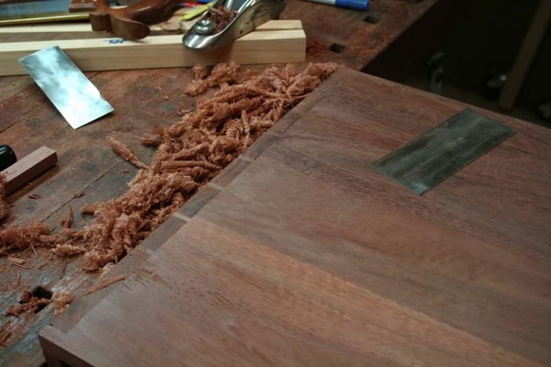

Card scrapers and scraping planes (vertical handles as found in a bench plane)/cabinet scrapers (side handles) are designed to serve different needs. The latter is a workhorse for large panels or prolonged duration of use; the former for touch-ups, and quick and smaller jobs. For spot-treatments/tight spaces/non-flat areas and curved surfaces, card scrapers are the natural choice.

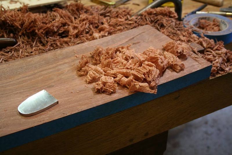

I do use cabinet scrapers (card scrapers) quite frequently. Sharpening them is quick. Always with a hook: http://www.inthewoodshop.com/WoodworkTechniques/FoolproofSharpeningOfCard(Cabinet)Scraper.html
They are good for areas which are otherwise tricky or hard to work in ...
... or I use this thick one (made from the rear of a plane blade) for shaping curved areas (this is a bow drawer front)...

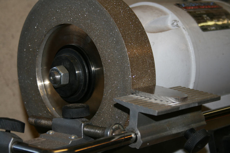

The last one is amazing! The hook is formed by hollow grinding the edge alone ...
