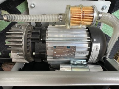

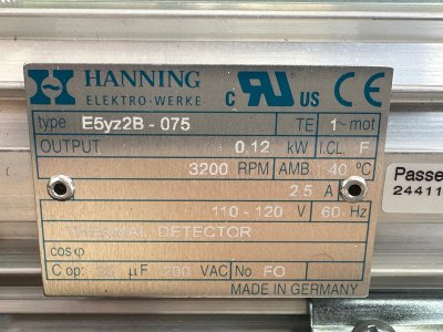

Are you looking for the supplier of Festool's vacuum pump? If so here are some photos I took of the inside.
Thanks cheese, I've been looking for and saving as many pics so can from FOG, to try and work out what I'm doing.

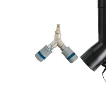

Are the airline fittings the same - like could i use parts from the IAS2/3 etc for the vacuum clamp/pump setup
I can get a double adapter which is now under 1/2 price on clearance, with 2 QC fittings, like below, will these work for vacuum clamping, then i would need to work out the air line size after.

Looks to be a standard fitting, same as some pneumatic equipment I've bought previously. Can't quite remember the type name though, Milton?
Milton is what pops up in almost all the vac sys threads.
The top of the y looks like a milton.

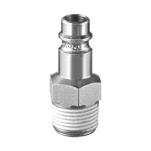

A different pic in another FOG thread shows the brand prevost, of which there is a company which sells them in OZ.
Those fittings are between 50 adn 75 each, much MUCH cheaper than the grey and green.
But, the only indication they take Milton fittings is the pic,
Same?
Yep, the exact same thing, but half the amount.

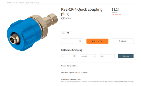

I found some awesomely cheap festo connectors, was pretty keen, till i checked the freight cost.....
Jb tools was exactly the same cost, in USD.
Id have to work out exactly what size hose i want, and what connectors and get them all in one go, if i was to go this way.

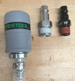

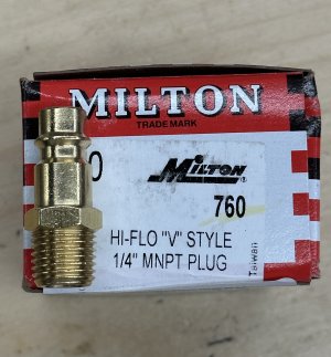

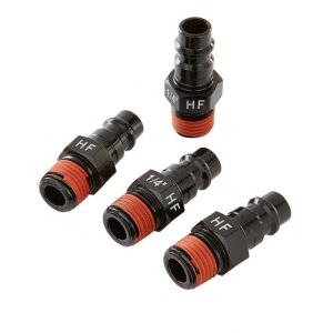

Others have used the Prevost QD connectors successfully and they are much cheaper than the Festool variety. Here are some photos of the different plug connections that mate with the factory Festool QD connector.
1. Festool steel and Husky HF aluminum, HF is for high flow
2. Milton brass HF
3. Husky aluminum HF
4. Milton aluminum HF
5. Prevost steel HF
