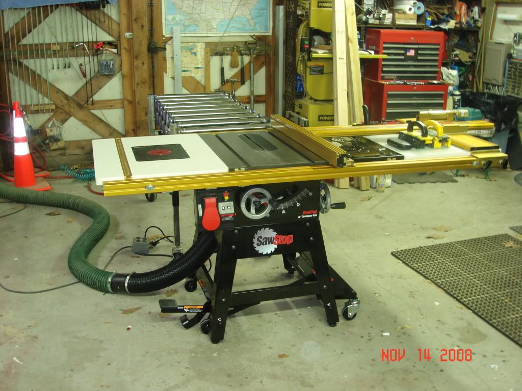

I was all ready to make the order for the Saw Stop when I thought about some of the things I had read about Festool over at Saw Mill Creek. I was also concerned about dust collection. I had purchased the Oneida Super Dust Deputy, and was pretty pleased with its performance when hooked up to my Delta AP 400. The down side was the amount of space used by everything. Another limiting factor for me was the lack of 220 service in my garage.
The Saw Stop I was going to purchase had a very similar foot print to the 22124. Every time I tried to do something that required walking past the table saw was an exercise in frustration. I had some shop built shelving on the wall perpendicular to the guide rail tube on the table saw. I wound up with less than a foot of clearance between the tube and the shelves. I had contemplated reducing the size of the tube because I hardly ever cut to the left of the blade. I could never bring myself to do it, however. I especially couldn't imagine doing it after spending $3500 or so on the Saw Stop. I had a crisis - permission to spend money but lots of buyers remorse and unsolved issues to get everything together before even spending a dime.
